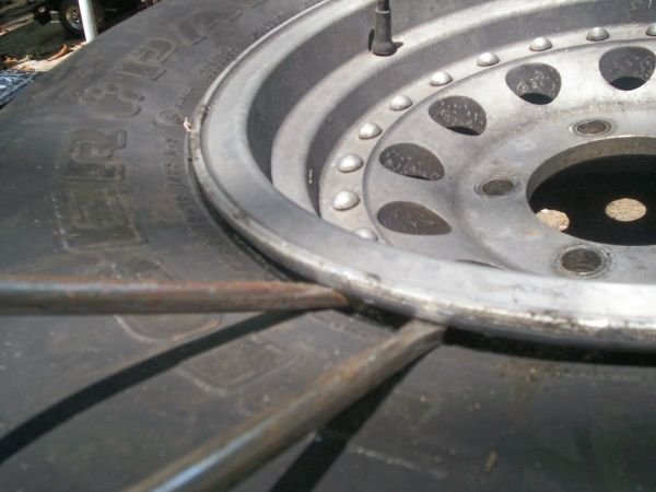

Use a pry bar to separate the tire from the rim. Screw drivers are NOT recommended as the tip can break off. Wear safety glasses to avoid flying pieces of the tire, rim, or pry bar. For stingy rims you may need some dish soap and a tire hammer.
Figure 3. Use pry bars to break the bead between tire and rim

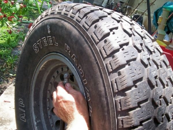

Step 4 - Replace the valve stem
Pull the old valve stem out and put the new valve stem in. You may want to add a sealer or tire grease to ensure a good seal. Just remember that whatever you put on the tire now may make it seal to a point when you have to remove it in the future. Use a sealer that seals, prohibits rust, yet doesn’t act as an adhesive. Tire grease makes surfaces slippery. This can increase the chance of blowing the tire off the bead. Take this into consideration when considering your safety.
