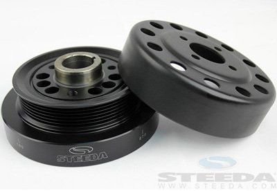

Steeda
Price - $180-$250
Material - Steel
Finish - Hard Coat Black
Warranty - Lifetime
Steeda underdrive pulleys are made of steel and are one of the most popular brands. Steeda underdrive pulleys are not a "piggyback" style pulley. Most pulleys (including the others on this list) replace the pulley attached to the harmonic balancer. This kit kit comes with a balanced pulley/dampener combo. Steeda is also rated higher than BBK with pricing ranging from $180-$250. Recommended if you intend to drive your truck hard with an underdrive pulley.
(Related Discussion: Steeda Underdrive Pulleys Opinions - Ford-Trucks.com)

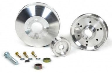

BBK
Price - $100-160
Material - Aluminum
Finish - Polished
Warranty - 30 day return policy
BBK under drive pulleys are made of aluminum and are cheaper than brands like Steeda and ASP, with pricing ranging from $100-$160. Although they cost less, reported charging issues make them difficult to recommend if you spend a lot of time in traffic. That said, those issues tend to disappear with any amount of throttle. Mustang owners with modular motors use these pulleys frequently without issue. Recommended if you want a good underdrive pulley in aluminum.
(Related Discussion: BBK Underdrive Pulley Review - Ford-Trucks.com)

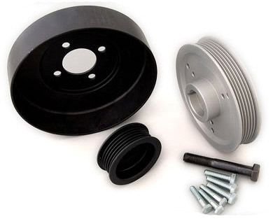

Troyer Performance
Price - $225-$310
Material - Aluminum
Finish - Hardcoat Black
Warranty - None
Troyer Performance underdrive pulleys are recommended and one of the more popular choices by forum users. The biggest claim is that the Troyer Performance pulleys are designed to reduce any charging issues. This means that they are ideal if you spend a lot of time in traffic or driving at slower speeds. They are made out of aluminum and are on the higher end of the price scale with pricing for a pulley kit ranging from $225-$310. Recommended if you need a pulley that won't give you charging issues.
(Related Discussion: Troyer Performance Underdrive Pulley Review - Ford-Trucks.com)
