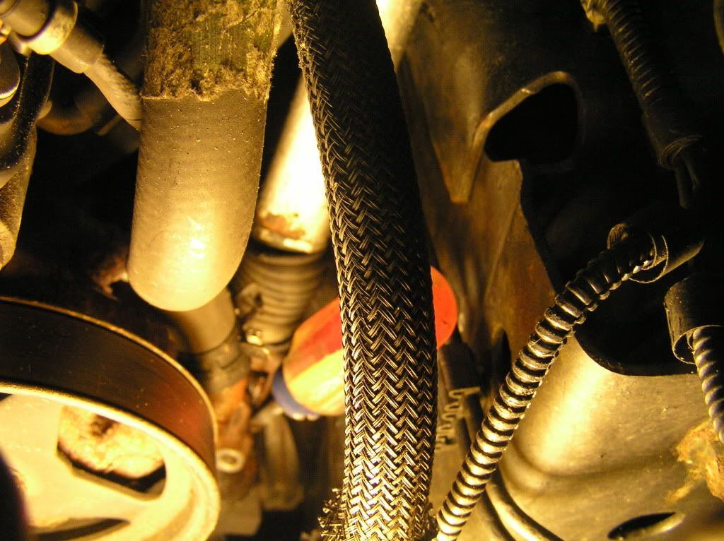

Step 3 - Remove lower steering shaft bolt
The 10mm bolt holding the lower steering shaft to the steering gear is difficult to get to, but you can reach it with an extension or by getting underneath the truck.
Lower Steering Shaft Diagram
Figure 4. You'll need to remove the bolt from the joint circled above. You might need a breaker bar or an extension for leverage.
Pro Tip
Soak both the bottom and lower bolts with liquid wrench before trying to get them off. If they're old and seizing, they'll be rusted and difficult to remove without it.
Step 4 - Remove lower steering shaft
If the shaft is rusty, hammer the slot where the bolt clamps to loosen it. Jam a flat-head screwdriver in the gap between the lower shaft and the steering gear to ease removal.
Lower Steering Shaft Repair
Figure 4. The screwdriver above is wedged between the lower steering shaft and the steering gear joint.
