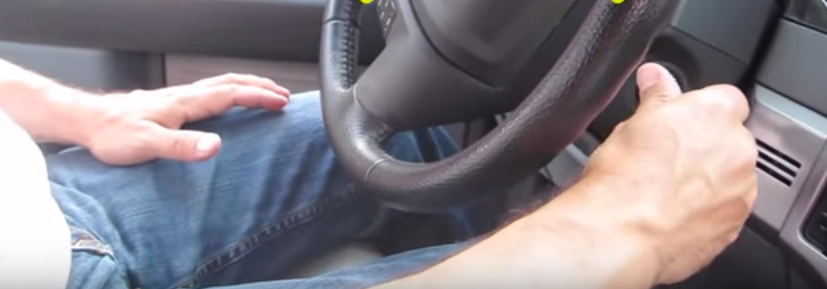

Step 1 – Insert programmed key
Before programming the new key, first insert the already programmed key into the ignition, then turn it ON and OFF, making sure you do so within one second.
ford f150 truck how to replace program code car key igntion DIY
Figure 1. Insert programmed key.
Step 2 – Insert new key
Within five seconds, insert the new key into the ignition, then turn it ON and OFF within one second.
Figure 2. Insert new key into ignition.
