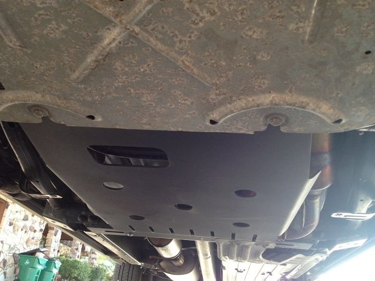

When purchasing a truck new, you'll be able to choose some options that you'd otherwise have to source aftermarket. These options include things like skid plates to protect the under side of your truck, locking differentials to help provide traction, and some trucks even come lifted to provide more ground clearance. The upside to going through the factory is you won't lose your warranty, the downside is you'll pay a high premium for parts you could have gotten for less than half the cost at an off-road shop.
