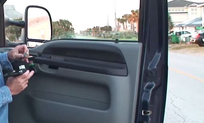

Step 4 - Disconnect switch panel
Go back to the switch panel that you left hanging. You can now disconnect it from its wiring. There is a connector on the back that you need to tug gently on. It should easily come off. Then set the switch panel down in a safe place like the car seat.
Figure 3. Disconnecting the switch panel.

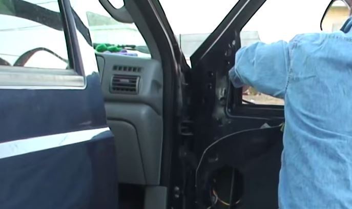

Step 7 - Remove speaker
Once the door panel is off the frame, you will need to remove the door speaker. Your 6mm socket will be required for this step. The speaker needs to come out in order to get to the side mirror's wiring, which is behind the speaker.
Figure 6. Removing door speaker.

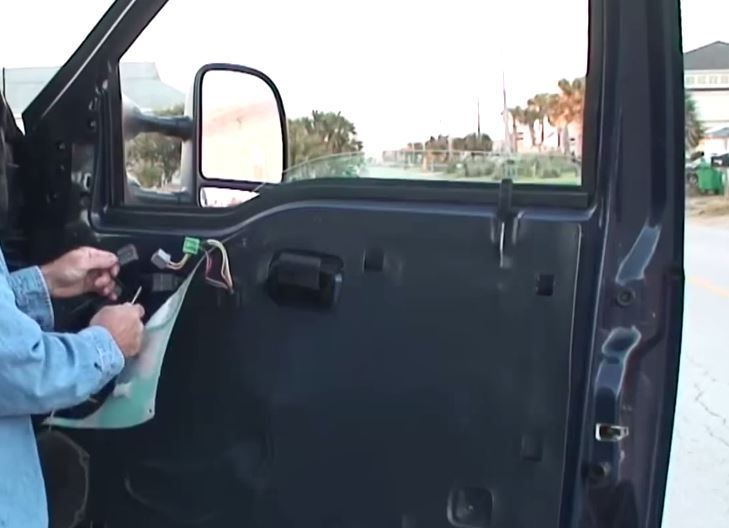

Step 8 - Unplug the mirror
Peel back the door lining and then reach through the speaker hole to unplug the existing side mirror.
Figure 7. Disconnecting the old side mirror.

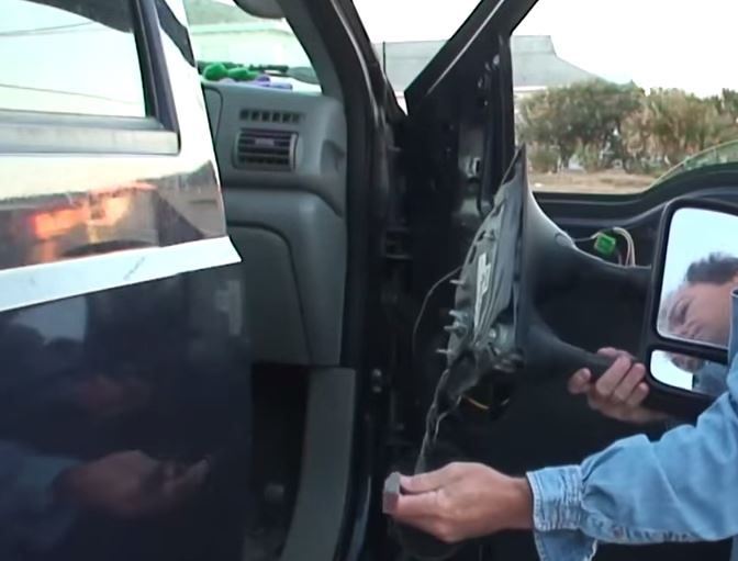

Step 9 - Remove mirror
With one hand you will use your 10mm socket to remove the mirror's bolts. Use your other hand to hold the side mirror assembly so it doesn't fall down and scratch your truck.
Figure 8. Removing the side mirror assembly.
Figure 9. The old side mirror has been removed.
