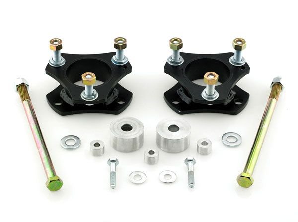

Strut Spacers
Pro Comp Strut Spacers
DIY Cost – An alignment ($60-100) and a few hours
Professional Cost – $200-350 including everything needed
Skill Level – Moderate, requires larger wrenches/sockets and removing/installing a ball joint
This is the cheapest way to gain any height on your truck. For 04+ trucks, Autospring and Hell Bent Steel are the go to brands. For the 97-03’s, Daystar and Springtech receive great reviews as well.

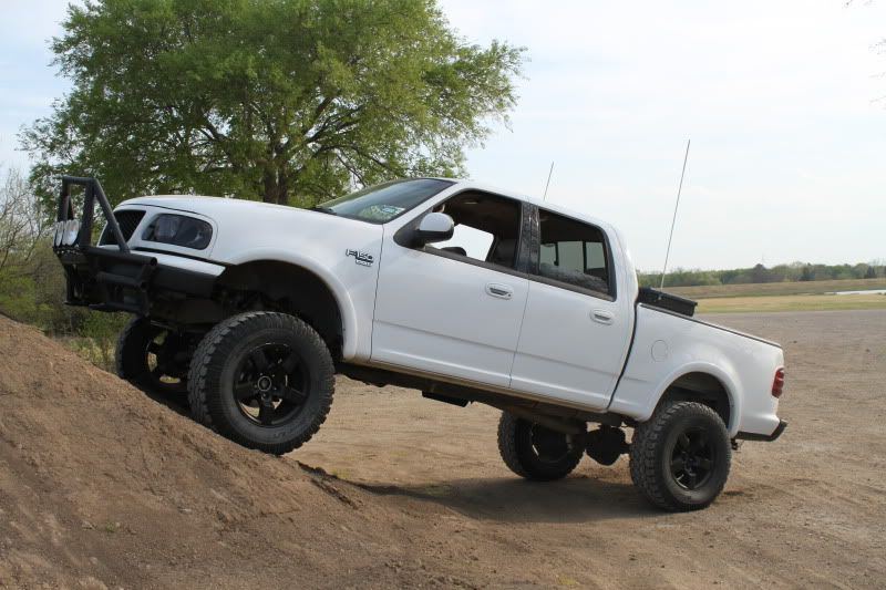

  • 03 King Ranch 6
    6" lift on 35" wheels
  • Desert Dawg F-150 4
    4" lift 35" wheels
  • Pockets F-150 6
    6" lifted on 35" wheels

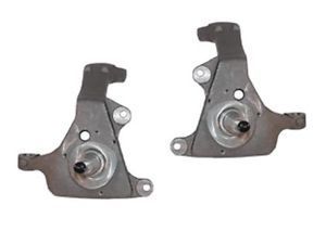

Spindle Lift
Lift spindles
DIY Cost – Cost of parts and alignment
Professional Cost – Parts plus $2-300 for labor and alignment
Skill Level – Advanced, removing/installing ball joints, tie rod ends, and wheel bearings
Spindles are a cheap way to gain 3-3.5” for the 97-03 2WD F150’s. They retain factory angles, but they do make the front track-width 1-1.5” wider per side depending on kit.

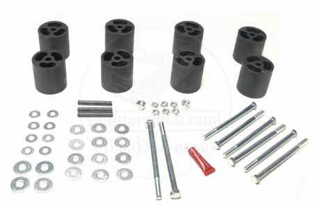

Body Lift
DIY Cost – $200-300
Professional Cost – Parts plus $600-900 for labor
Skill Level – Advanced, a lot of tedious work, allow 2-3 days for install
Generally the most affordable way to lift your truck if you can install it yourself. However, it leaves a gap between the body and frame which can be a little unsightly.

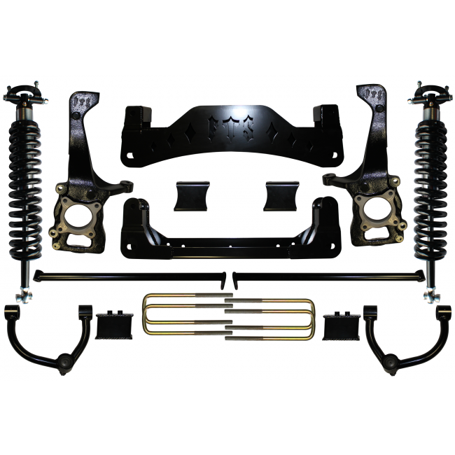

Full Throttle 8
Full Throttle's 8" Lift Kit
DIY Cost – The average kit costs between $2,500 and $6,000.
Professional Cost – Parts plus $600 to $1100+ for labor
Skill Level – Advanced, I’d recommend a shop if this is your first install
Full Throttle makes kits ranging from 4" to over 16”. The 10" and under kits generally receive good reviews, however the 12" and over kits are generally frowned upon when used by themselves. To properly run them you need to upgrade your brakes, steering, and more. The crossmember on them also isn’t very nice looking.
