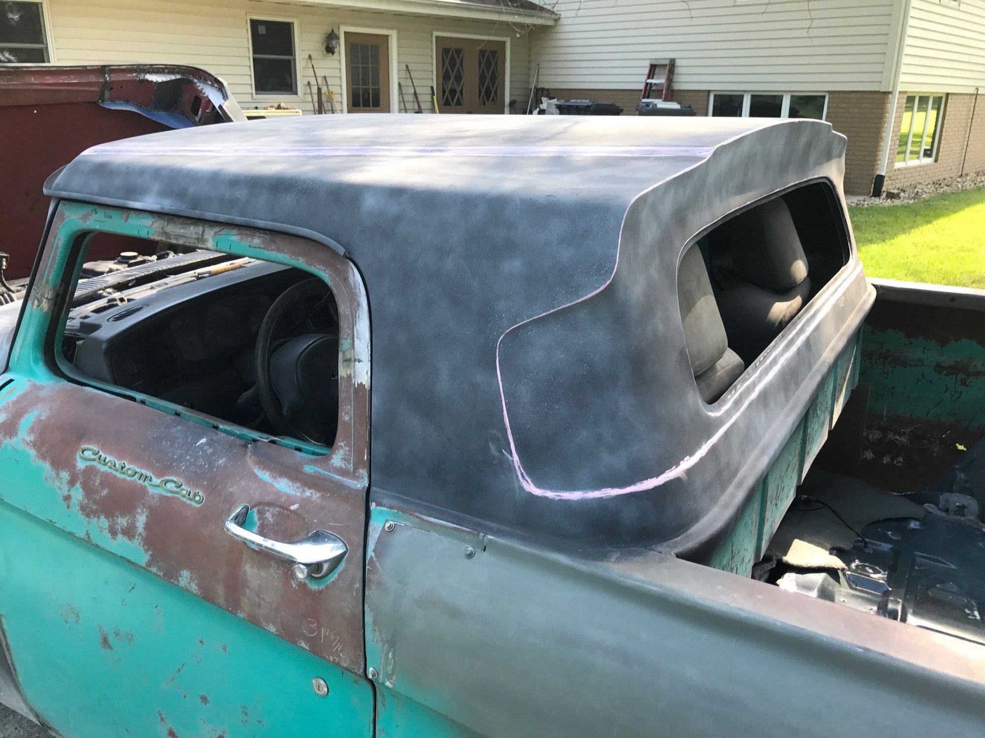

Chopped and channeled 63 unibody

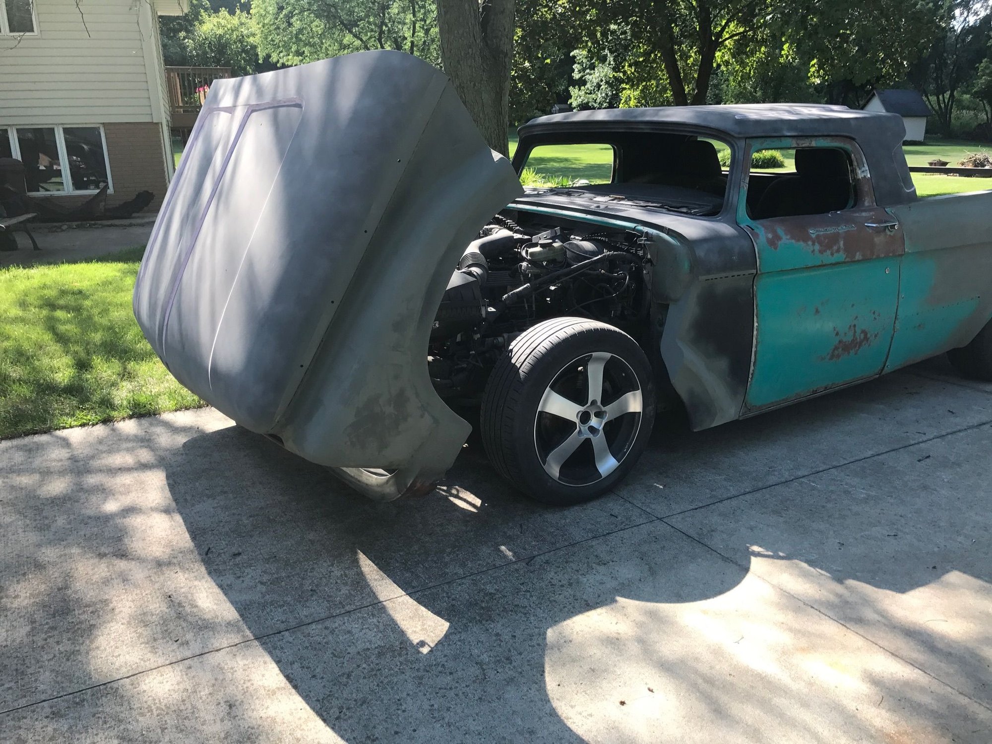

The tops of both fenders were cut and widened 2-1/2” to clear these wheels that have a much wider offset than the stock wheels Now the stock grill is way short If anyone would like to chime in on a grill design, that would be great
I had to stretch the roof back about 8” because my chest was rubbing on the steering wheel Originally the rear window would be almost at a 90 degree angle, but I thought it would ad some character to lay it down a few degrees The roof is the crown Victoria hood turn 180 degrees

I had to ad some 1-1/2” tubing bent to conform to the inside of the fenders, attached to the inside of the front bumper which is boxed in across the entire width The hinges are 1/2” plate I would estimate this portion was about two weeks to get it right, 12” hydraulic shocks will be used so I won’t need a hood latch

Copy the rear window outline and transform it to create the grill outline. Then use a simple egg-crate (horizontal and vertical aluminum slats) grill in the center. Headlight type and shape is up to you. With LED options you could make the headlights into narrow strips of headlights that disappear into the fenders when not in use..
