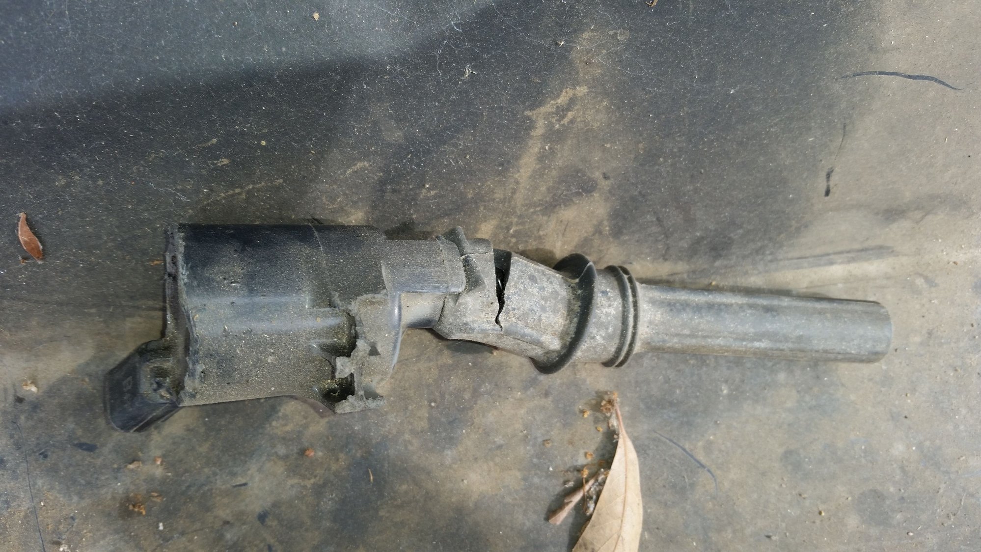

Originally Posted by EX40 View Post
These O-rings you speak of. Exactly where do they go? First time hearing of their use. Just picked up a 2nd Ex and will be doing spark plugs & coils soon.
See the double ridge where the helpful leaf is pointing?
That is where the O-ring fits.
You could RTV the O-ring there and then goop some dielectric grease around it.
This is what a coil looks like after a spark plug violently ejects. The departure force easily snaps off the coil hold down bolt ear.
