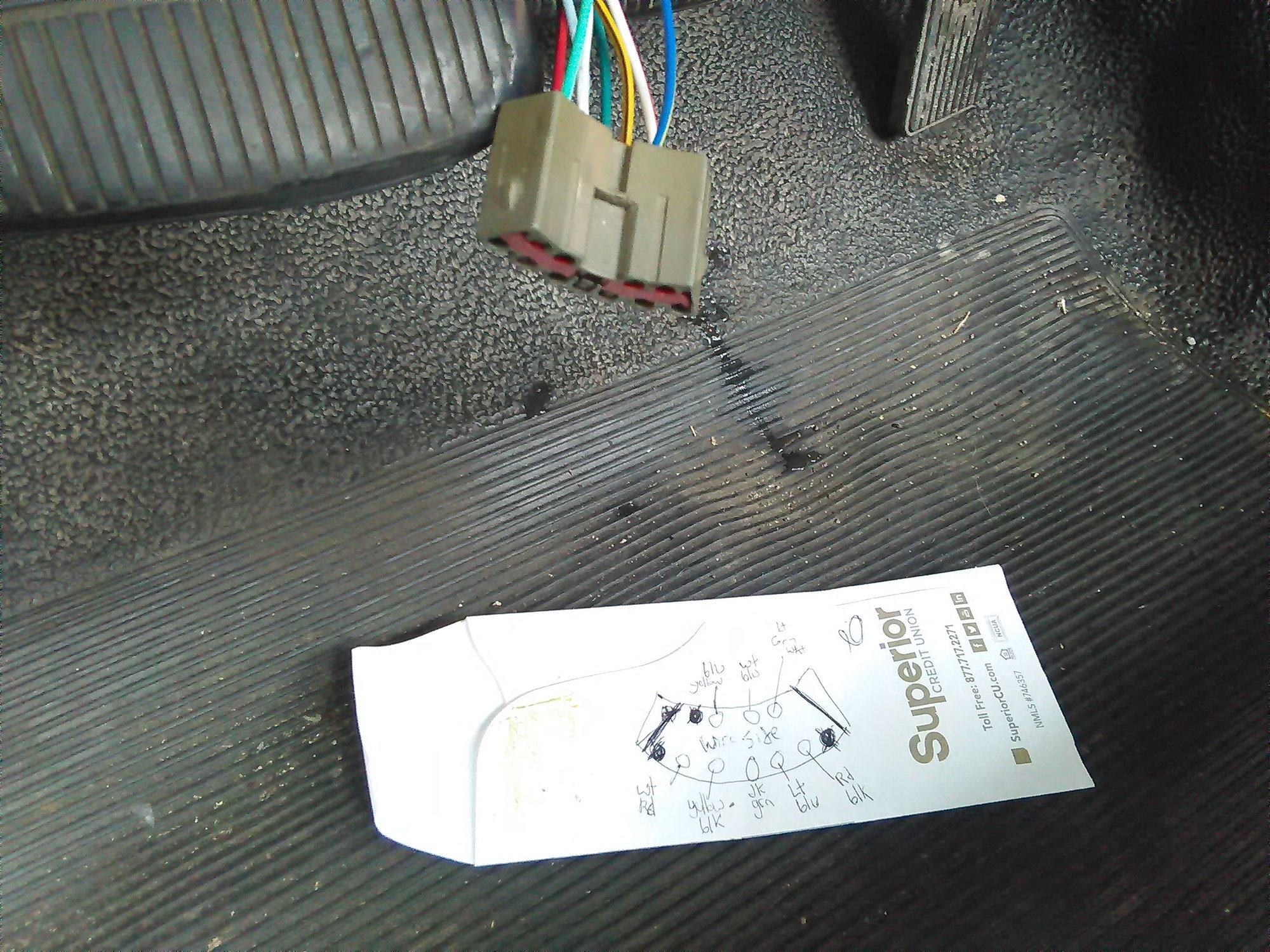

Thirdly, knowing better than to rely on new-fangled electronics, I drew a diagram of the connector with all of its wire holes (from the wire's side's perspective) and labeled each with its proper wire and stripe color.

Next I did what I maybe should've done before feeding the wires through the column. I connected each pin from the new switch to its appropriate pin in the opposite connector, (according to my written diagram) and tested the switch. All systems go! So I pulled the wires/pins all out and installed them into the connector block, and plugged it in and tested again. Same results as before! Being confident or stupid or probably both, I went ahead and left the accessories powered up the whole time so as to not interrupt my music.
