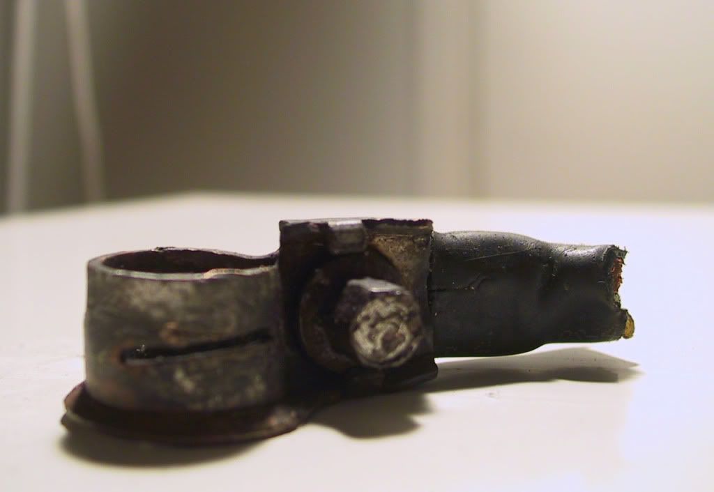

Well you would never guess what the issue was. After checking almost everything in the world on this truck my dad finally decided enough of me looking like a chicken with his head cut off and he got in there and used some voltmeter or something and it ending up being this thing: GRRRRRR
It looks like it was a simple case of since the truck sits so much that the one of the post became corroded because of the battery. I headed to sears to get that battery replace and of course we added another connection to the cord.
So shes up and running Perfect now. Thanks guys for all your suggestions and help!!!

Originally Posted by 4x4EX View Post
OK, so I did as suggested and I checked both wires coming from the battery. Both were corrosion free (as far as where the two wires connect to the battery) and it seemed like a solid connection to me.
This is what you said in post #4.
Guess they weren't.
Glad you got it fixed easily. Hopefully, inexpensively, too.
