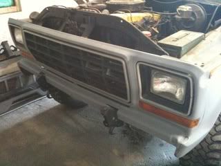

So this is what I started with 79 F150 4x4 shortbed with 300 big six, granny 4 speed, lumpy bondo work, rustoleum paint job, and a worn out drive train. Doesn't look to bad does it haha

I started sanding it down and took the bed and fenders and hood off the truck
I also made a few trips to the junk yard and bought those 15x8 steelies, some corner lights and headlight buckets and found 4 mint dog dish hub caps that you can see test fitted in a couple of the pics. Also found some stuff of craigslist, a full rebuild kit for the motor for $200 and a nice undented grille shell for $50. I found a mint steering wheel on ebay and mint horn pad as well. The horn pad is rapped in the blue shop towl. Here is a picture of my parts shelf.
