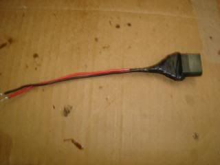

Next to free speaker harness
I am finishing up installing my new speakers into the Bronco.
I donʻt know if anyone else has reused their OEM speaker parts, but here is what I did.
OEM speaker with connector that can be reused.
I used a soldering iron to unsweat the wires from the connector.
Here is the connector that is free from the speaker. I also cut back the
metal area where the wires attatch to the connector.
Soldering new wires and making a harness is a snap, I wrapped electrical
tape around the harness for safe keeping.
Harness soldered to the new speaker.
New speaker in stock location
Removing the grille and giving it a fresh coat of paint made a big difference
in the appearance. Soon the black grilles will match the new black vinyl flooring in the Bronco.
Grille before
Grille after
Reusing the stock connector saved me at least 30.00 on two sets of harnesses. Also I would have had to wait at least a week for the parts to make it here.
At least a small part of my Bronco is going "green".
