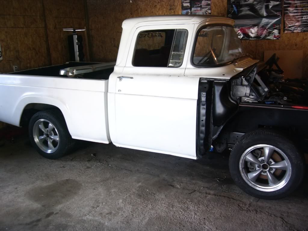

update and pics on mine
she is getting very close to crankin up and takin out for a spin, still got fuel (regulator is in the mail) to run, driveshaft and exhaust should be done this week, ignition switch, finish up the throttle cable bracket, run rear brakes, and put the front clip back on and wire up all the lights. heres some pics i like the new stance after i pulled out the overload springs in the back and put in the 8.8. by the way i will be cleaning up all that wiring, i just didnt want to cut anything out till i know it runs, then ill get to hacking out all the stuff im not using
