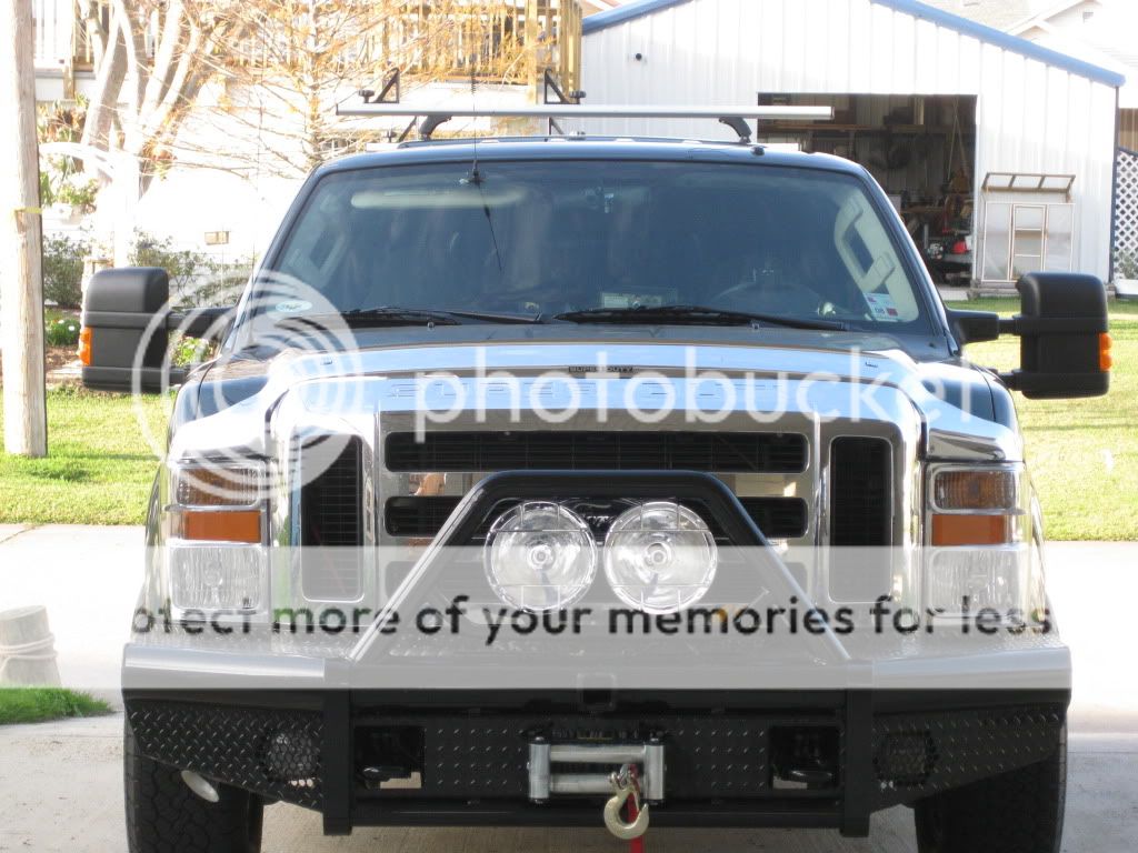

[IMG][/IMG]This one clears the grille fine, but the lights touch it, I just flex the grille in, no problem. The grille probably would flex 1" easily.
