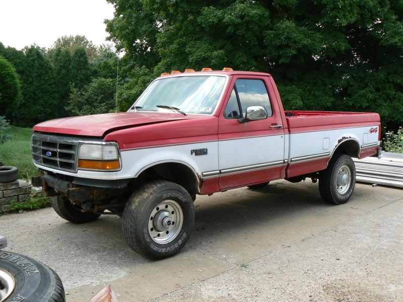

Thanks for the welcome! what is the axle diffrence and how do i find out which 250 i have ???? i dont have a solid front axle if thats the diffrence. heres the truck. i would take pictures of my dodge to but i dont want to make anyone mad. a couple of the cross members are pretty rotten to.
