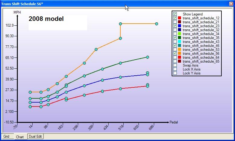

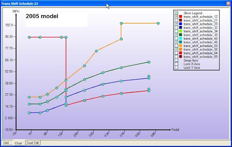

Not to get too techy here but here is stock shift strategies (NON TOW HAUL MODE) from 2005 model and 2008 model V10's. 05 model at light TP uses 3 gears. 4th -5th gear uses same TP and MPH to shift aka skips 4th all together.
Mike, 4th only gets used when fluid temps are below either 32F or 0F( I can't remember which). It's a 6-speed trans, and it uses 5 speeds all the time-it will either use 4th or 5th on it's way to 6th gear,but not both.
