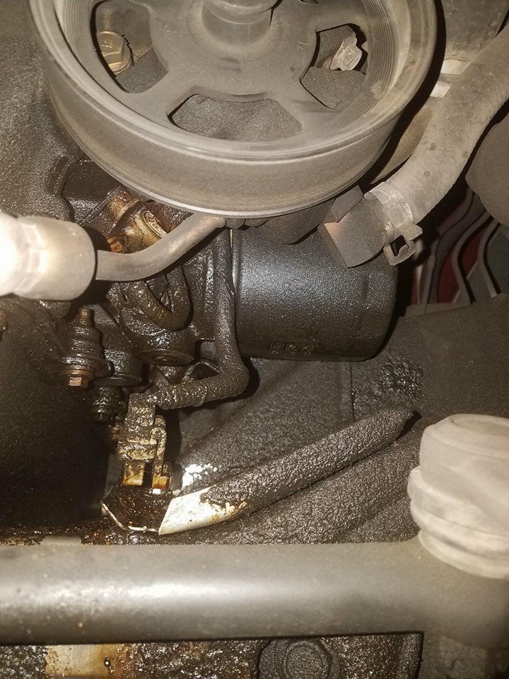

2001 4.6 expy
Originally Posted by SSG VA BEACH View Post
Here is the gasket and part number for anyone else that may run into needing one. 4.6 Romeo
Hello guys i know this is a old thread. Searched the forum maybe searching the wrong thing but noticed I had a small oil leak from my expy I just bought. Looked under the truck and noticed a wire dangling. No codes so not sure what this is for. Pardon the nice sludge build up I plan on cleaning this up so I can pin point the leak. It does apear to be from the oil filter assembly. Thanks in advance!
