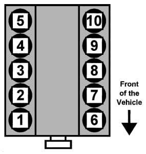

Originally Posted by captdean View Post
2001 SD , supercab,long bed, 5 speed 360875 miles. Just now having misfires p0357 codes, can't find out what's doing it.
Actron site says that code is failed ignition coil G which by my finger counting should be cylinder #7.
