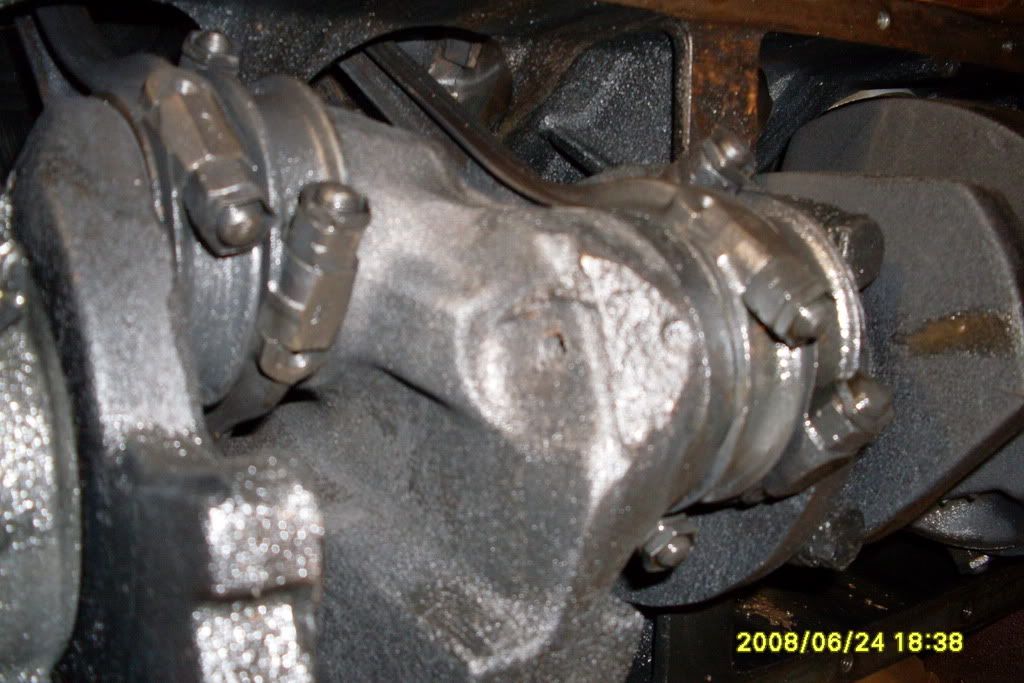

Petey thanks for the advice, that's exactly what I'm gonna do. Well I made alittle more progress. I flipped it over and started take'n out the Pistons....I got all but two of them free tonight....I'll be soak'n and work'n on those two for awhile. Did see something kinda odd on the crank though, looks like a big chunk is missing...You guys advice...Normal?? Anyway here are the pics.
