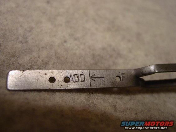

Here are some photos
Hi Numberdummy,
thanks for your response. I couldn't find anything in any of my Ford Master Parts Cross reference catalogs either. Maybe someone can do a photo ID:
RDave
