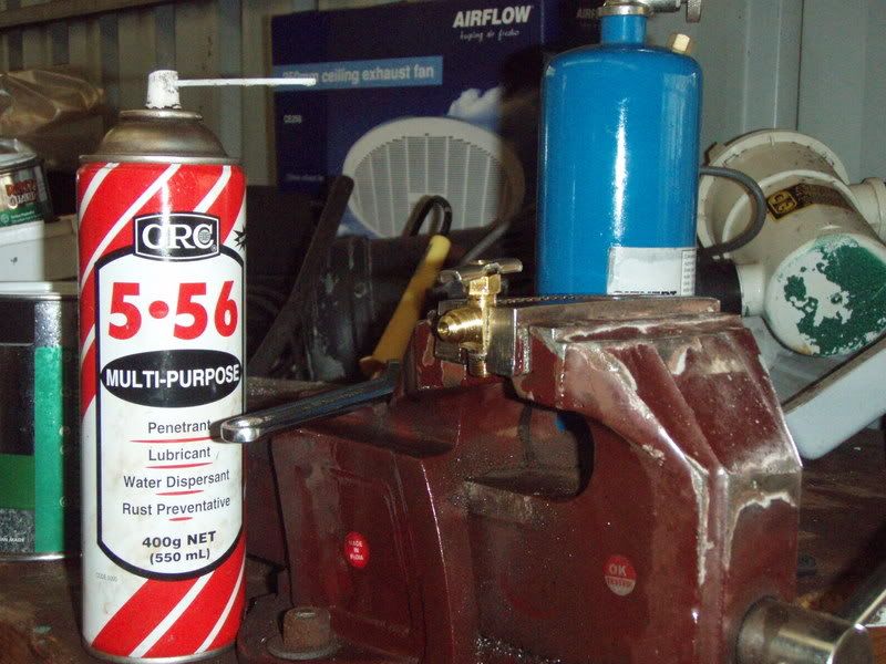

The little brass auxilliary drain tap they give you in the kit for taking oil samples, seems to be stuck closed on mine!
I tried opening it with a small shifter (AFS = Any Fricken Size) spanner but it wouldn't budge and I didn't want to break the weld holding the tap handle on...so I didn't force it!
The securing nut for the tap spiggot under the handle was loose, even if I loosen it further until it winds up to the underside of the tap handle - the little tap spiggot still doesn't seem to want to turn!
I'm going to try flooding it with some CRC today from the top and back thru the removed end cap, to see if I can free it up, and have another go....
Is there some secret "trick" to getting the little tap to work (open) for the first time??.
Tappping it with a hammer maybe?
A little heat from a butane torch maybe?
I dont want to screw this up - and knowing my "passionate fingers", it's quite likely I will!

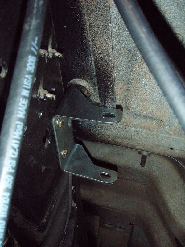

Well - thanks to all the help from those of you here I actually got it all done today! Even went for a test drive - and no oil leaks so far!
This of course would be a minor miracle in the making for lil ol passionate fingers me!
Now-I didn'tmanage to get the damn stuck tap to open - but at least I didn;t break it either! It's installed into the top of the bypass filter - but just not useable is all!
I figure I can always drop the filter body and exchange the tap for one that works, when I can eventually get a hold of one!
BUT, everything else seems to be working fine so far!
I installed the bracket against the outside of the chassis rail as suggested!
The stuck tap remains on top - out of harms way until later!

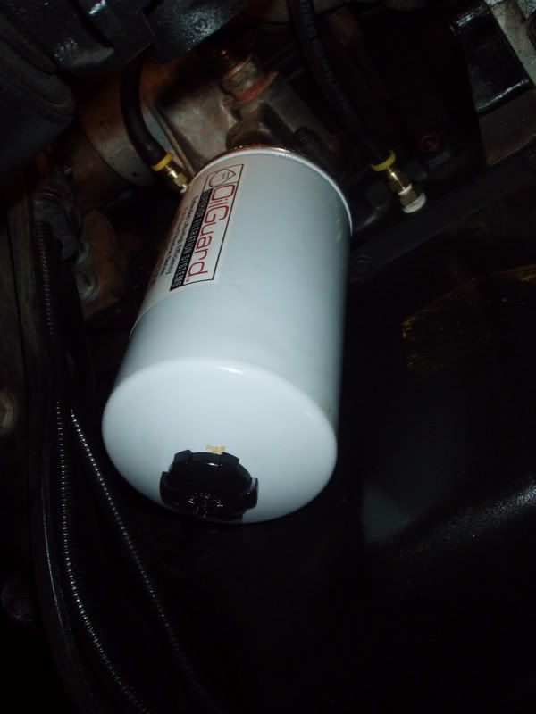

Install continued!

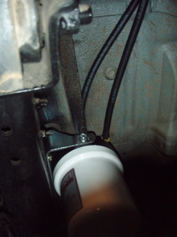

As suggested, I dropped the full oil filter (and managed to get a Oil analysis sample while I was at it!) and this made it much easier to do the oil pressure lines install!
You can see it was a bit crowded up in there without removing the full flow filter!

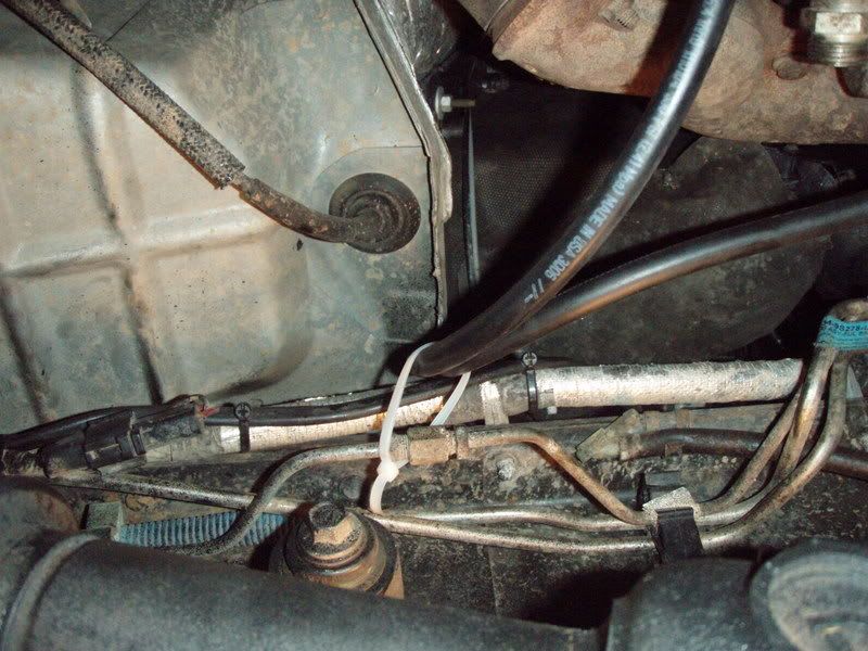

By using cable ties and routing the oil hoses up over the body and chassis rail - I was able to keep them a good distance away from the exhaust manifold to protect against potential temperature damage to the hoses!
I do have to say - that pushing the hoses over their barb couplings was a monumental effort, I can fully imagine they should hold up to their rated 350 psi rating, because we (the eldest son & I) used boiling water to soften the rubber and pushed like a couple draught horses, to get them to butt up tight into their plastic collars! This parts no where near as easey as the destructions sheet would have you believe!

New Oil Guard Full flow filter full of new oil installed in place of the old motorcraft one!

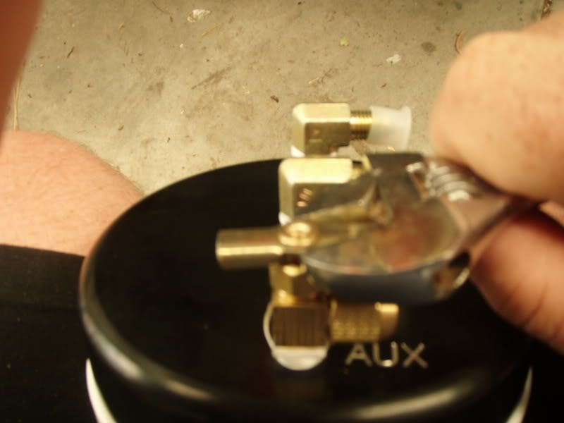

This is the danged stuck sample tap, and a few of the various methods I tried to use to loosen it up - including CRC lubrication and butane torch applied heat and just sheer brute force!
I ended up loosening the fit between the tap handle and it's shaft somewhat, but the stubborn dammned shaft remained firmly jammed shut - where it now resides!
I'll write Oil Guard and see if they have a replacement / spare tap that actually works - and replace the offending one when I get the replacement!
