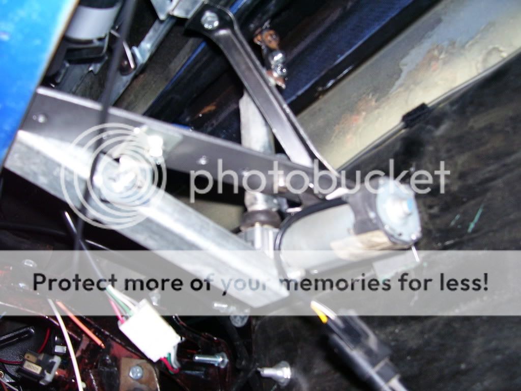

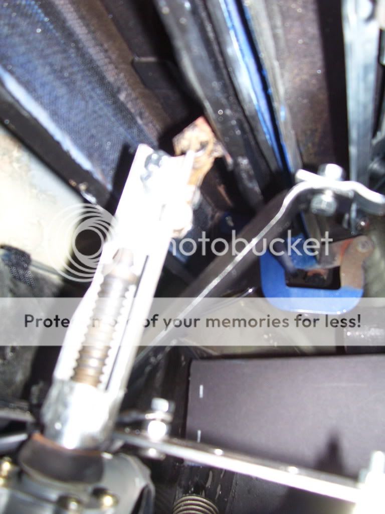

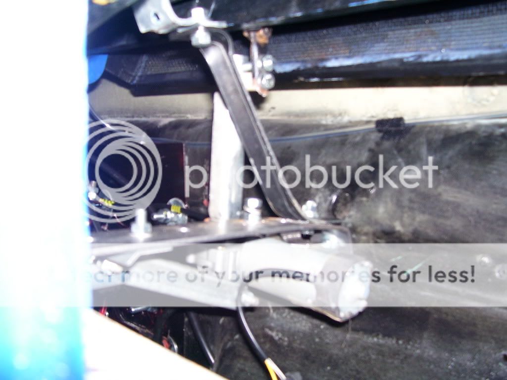

Heres how i did mine:
I used the actuator from underneath an electric seat. I think you could adapt just about any actuator though so long as its about the right size. My install pivots at one end as the worm screw pushes/pulls the vent open/closed. It works perfectly and seals nice. You have to remember to put a stopper at the limit of travel you want to work with though!!
