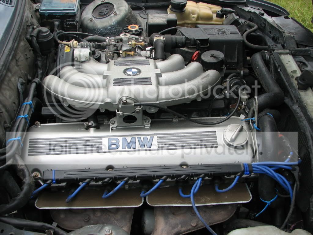

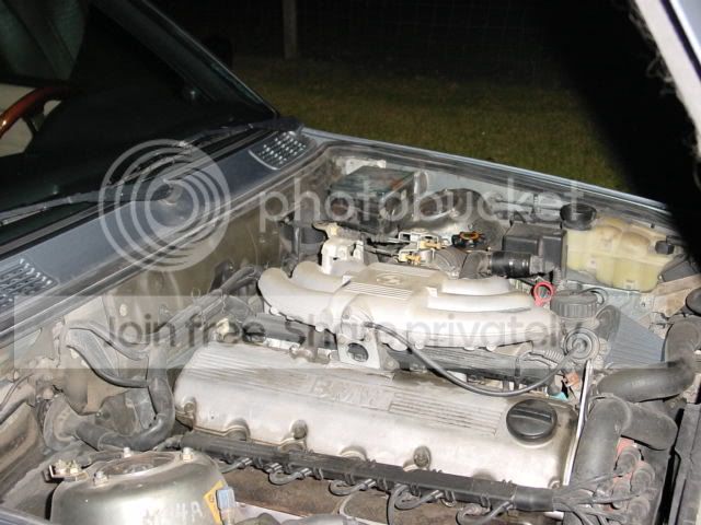

Well. I think it cleans your engine bay up a lot. I have a BMW that I painted the valve cover, intake manifod, and oil pan on and it looks great. I also painted the lettering and raised pieces. looks much better. Here it is before
and after

That made a huge difference, thats for sure. I thought I had done a good job cleaning up under the hood of my 95 bronco xlt till I saw the pic of your beemer
