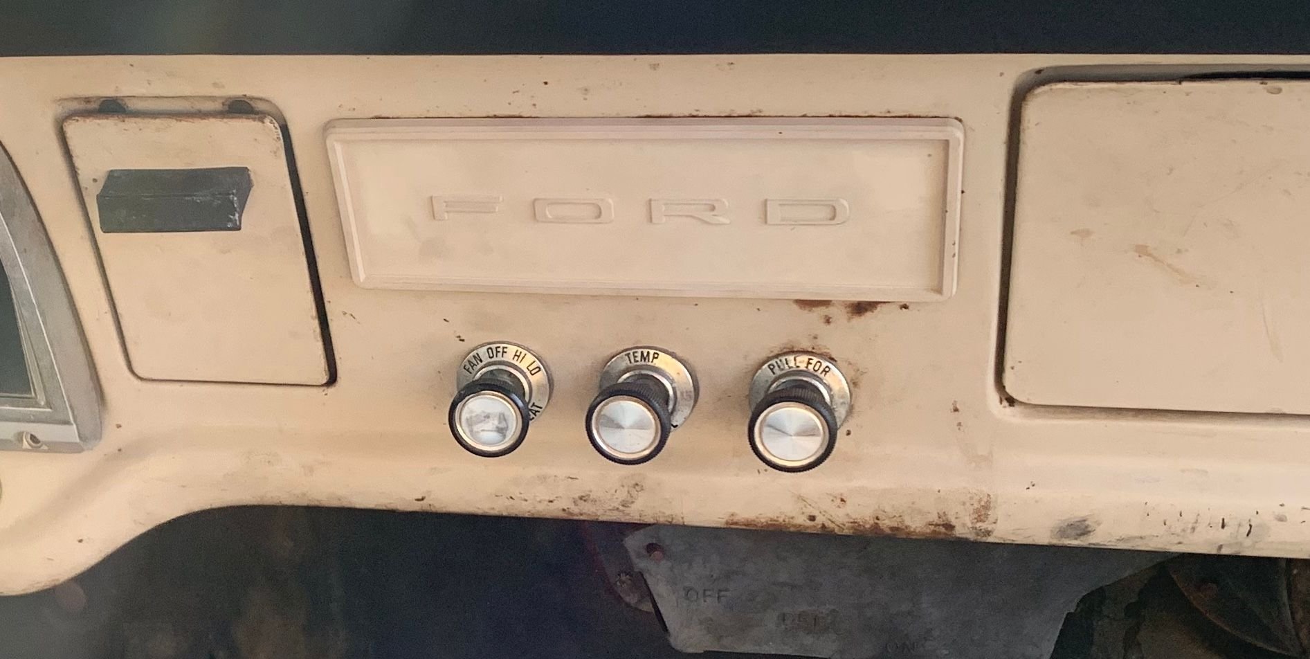

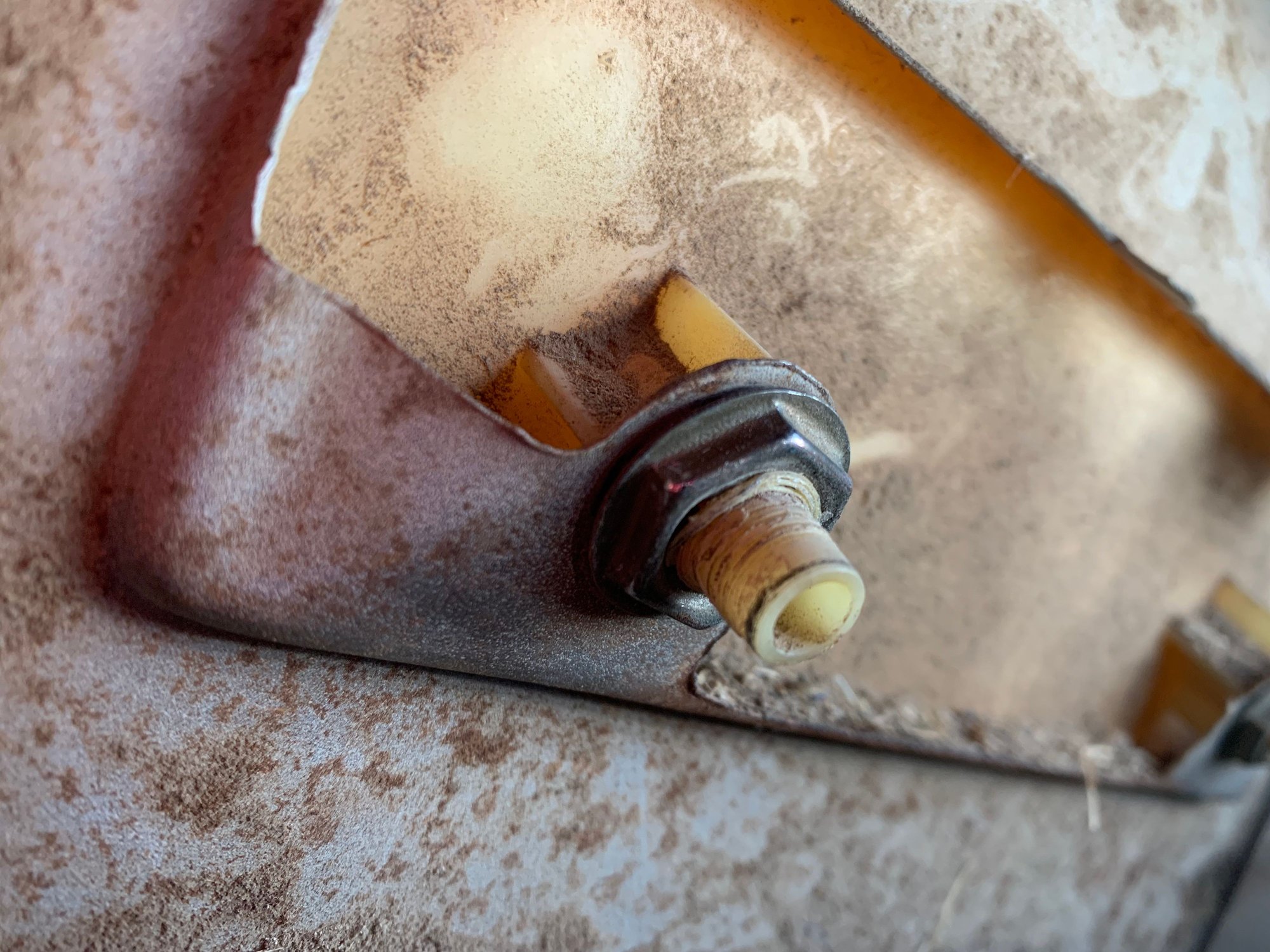

I know this is an old thread, but I can’t get this bugger off either! I can’t tell if the nuts are stripped or what, it’s pissing me off!🤬

They should just unscrew. Looks like they might be stripped. Gently, emphasize gently, get something between the dash and that nut and then turn it off. A little help and it should “catch” and turn off.
I just paid $40:for a good one of these, and I thought that was a bargain...

they are hard to get loose cause that nut is so thin. stay after it. I took the glove box liner out to get to it.

So it ended up, to be cross threaded on one of the posts, that side broke off, but I think I can epoxy it and retap it, but when I got it off, I realized that damn thing is plastic! I thought that plate was metal!
