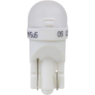

Sylvania basic 194 LED
I tried the Sylvanias first, and though they had good, even lighting - they were way, way, WAY too bright.

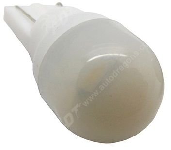

I found something that looked like this (as best I can remember)...
Generic Frosted top 194 LED.
They had them in all of the basic colors, and had the matching #74 LEDs.
