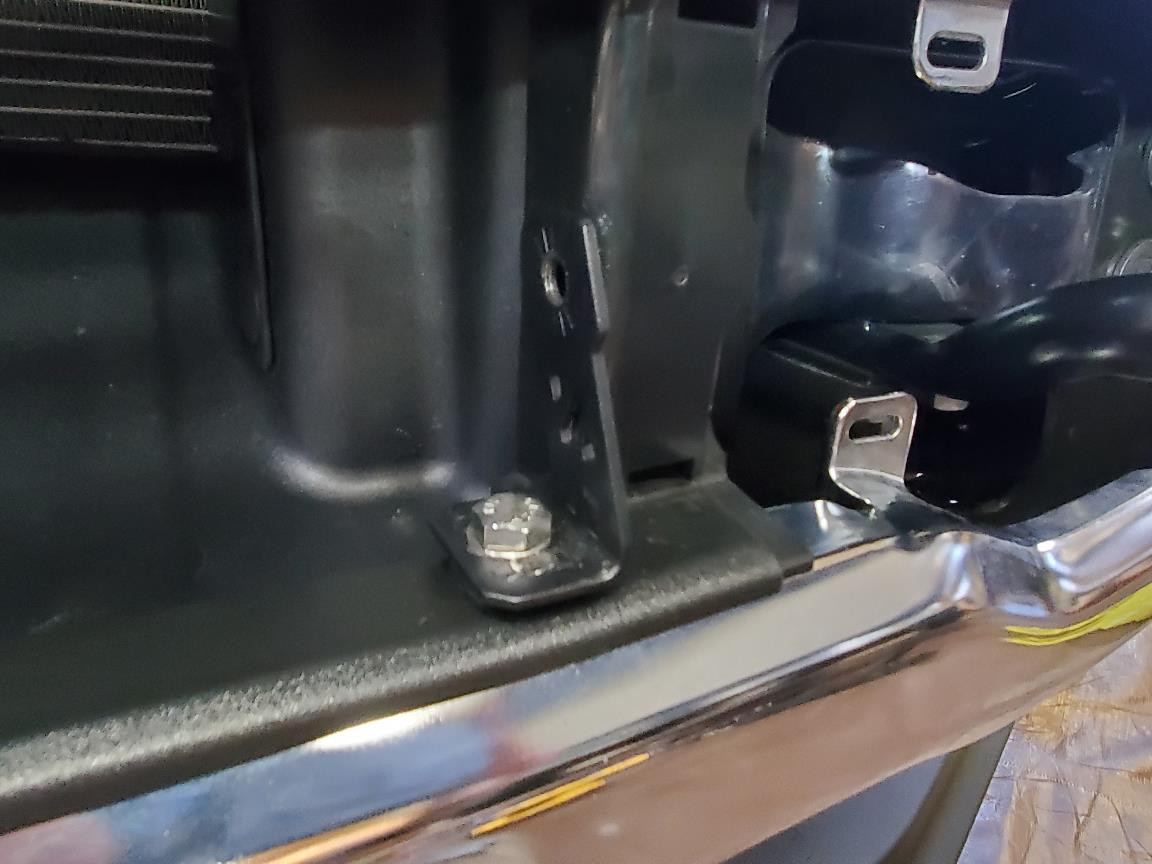

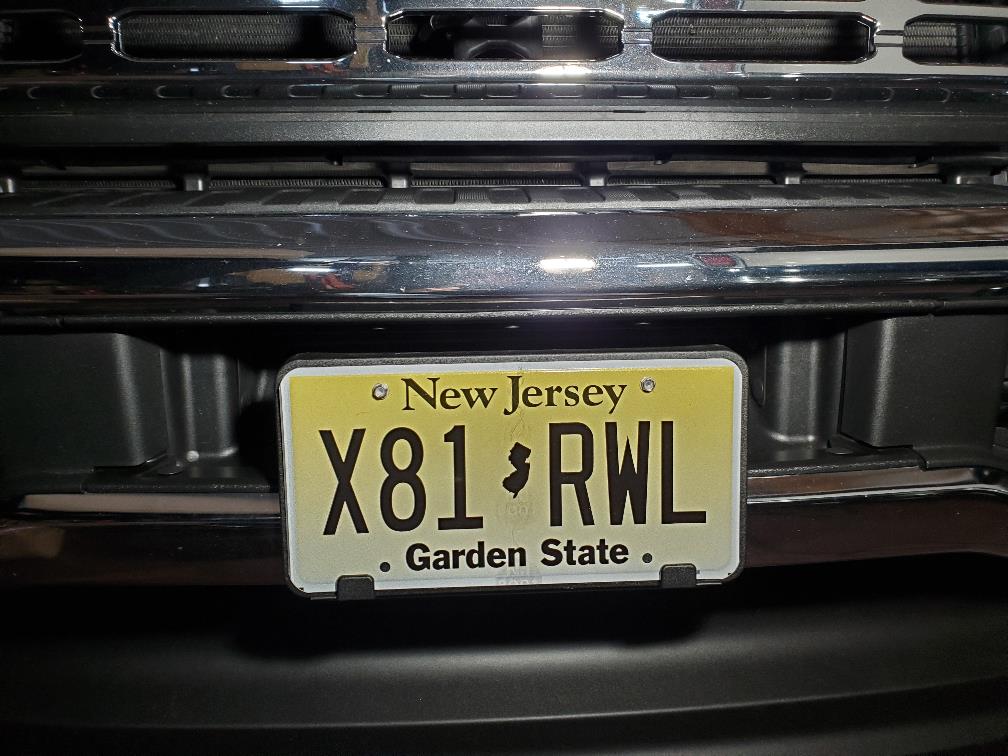

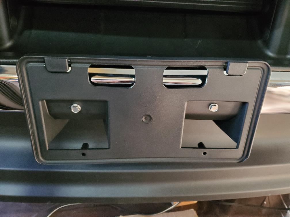

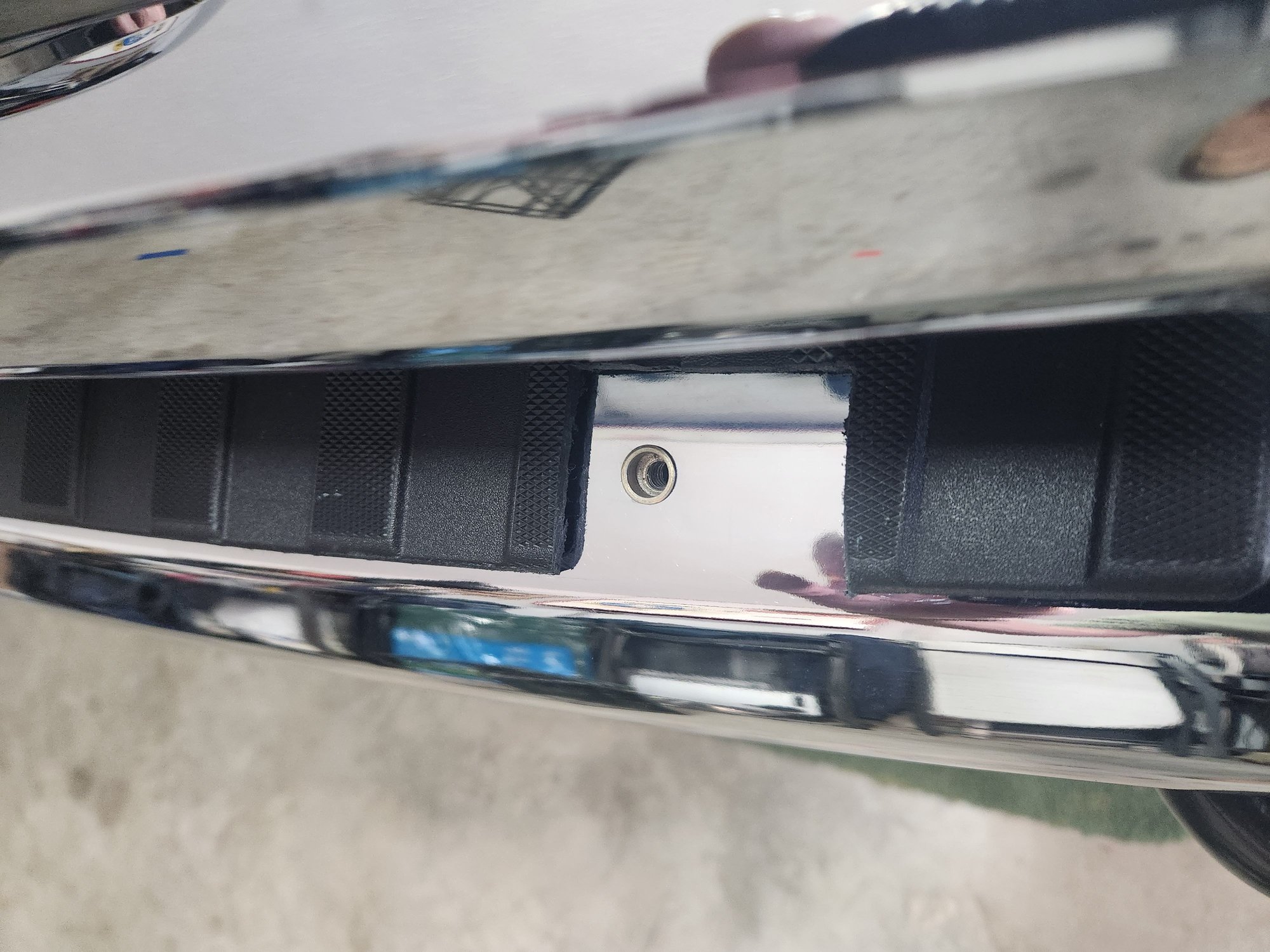

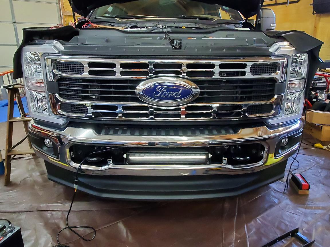

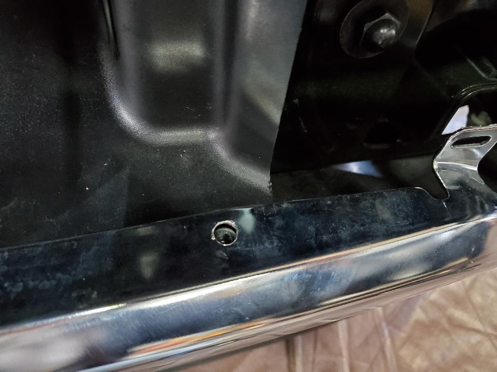

Mounted mine flush in lower intake hole.
Used holes already there.
Lisc plate blocked most of it anyway.......
Did move plate down, which did require two new holes in bumper.

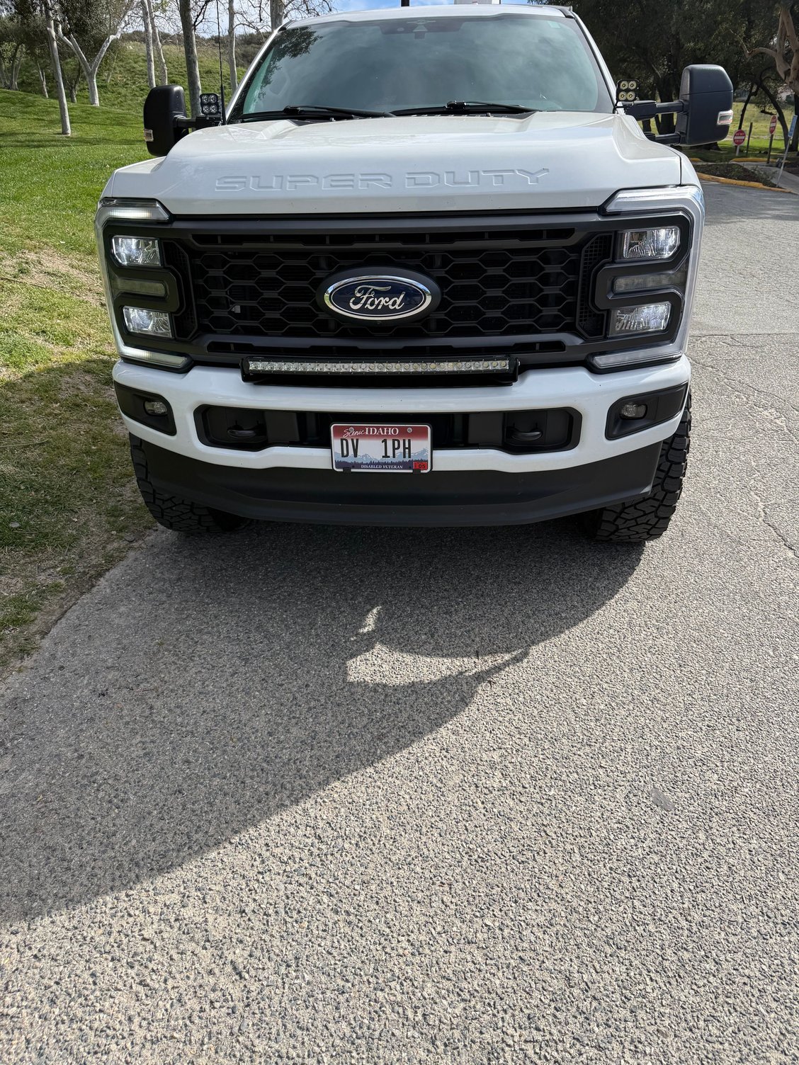

I have the zroadz brackets and used a light bar from f150leds.

Keep an eye on that light bar. After about 4 months the seal on mine gave up and water vapor had condensed inside the entire length of the light bar.

Mine has been on about a year with over 20k miles. No issues right now.

Interesting on the existing holes, will think about this.
