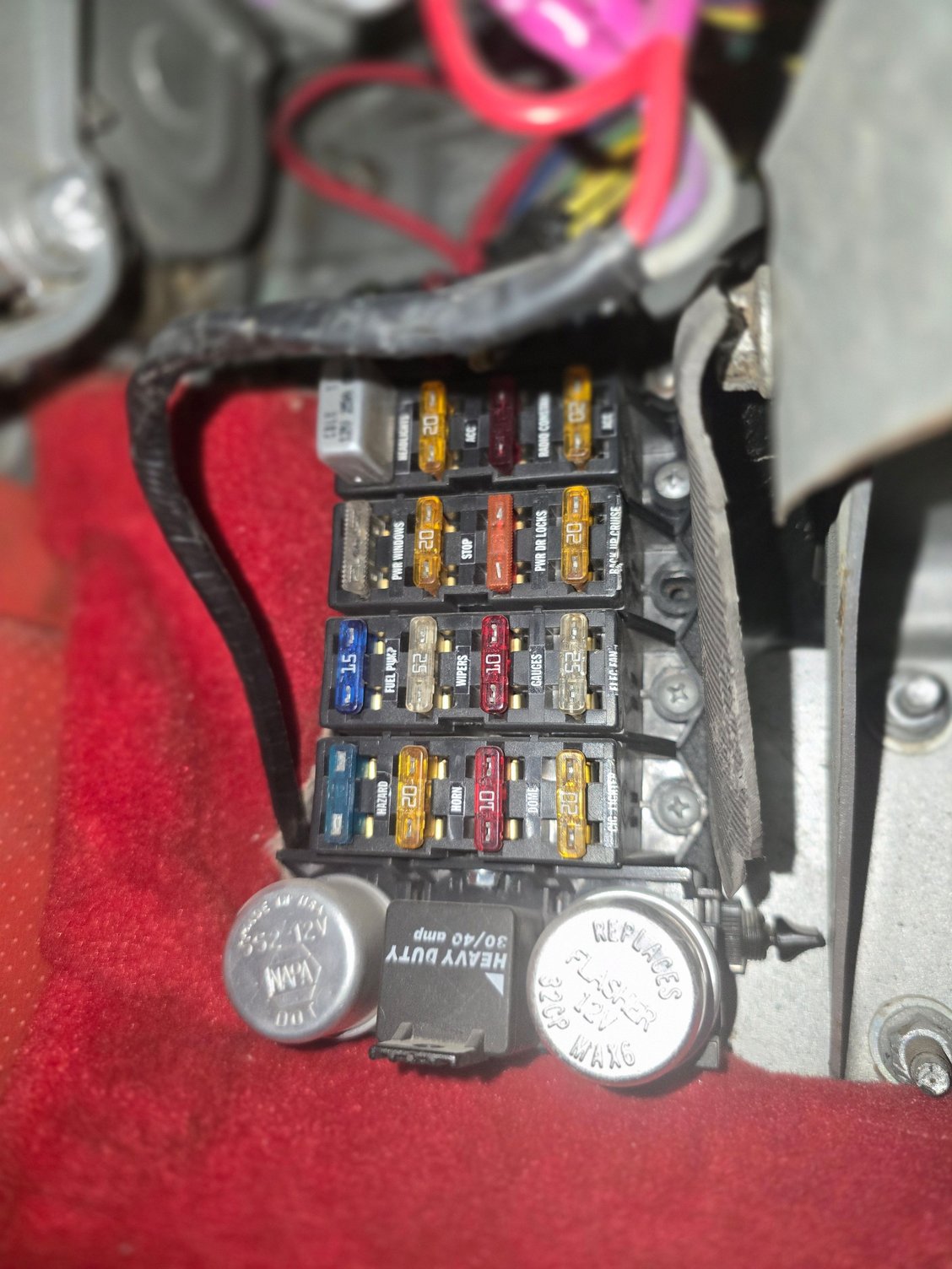

Hi, I would like to know my wiring harness is from which company is it possible to know?
since it might be a general one.
Since I am currently facing issues such as poor power for electric windows, guage milage screen flickering and some times disappearing, no signal lights, low signal sound, ac not turning on, some guages such as fuel and oil pressure dont come back to 0 directly after turining off the car, fuel fuage moving when driving the car, and guage lights lose brightness after while from turning on the car.
could it be due a bad grounding?

Definitely would check for good grounds.
Your's looks very similar to this Jegs Performance 10405: https://www.jegs.com/i/JEGS/555/10405/10002/-1

Thank you very much, seems like it is the one.
Just discovered a new ground wire location and the copper seems oxidised, hopefully this is the problem.
