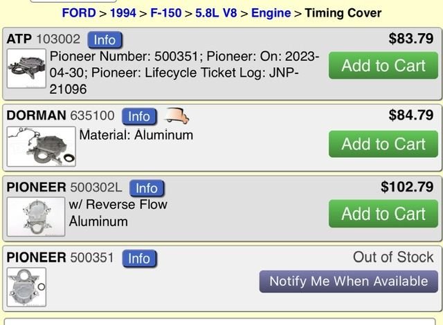

1994 F150 351 Windsor engine have a leak at the top of the timing cover ,,, either water pump gasket or the timing cover has corroded to the point of being porous going to pressure test the system this weekend to find out the point of leakage ,, if it is the timing cover itself would anyone on the forum know the correct part number for a replacement timing cover that actually fits ,, when searching for new cover reverse rotation ,, hole for crank trigger sensor confusing to say the least . thanks

If coolant is pooling on top of the timing cover it is more than likely the gasket between the cover and the block. There would be coolant sitting there when parked for serveral hours/ overnight. Confirm with a pressure test. At least that was my experience and a couple other people on here.
Not confusing at all. Here are three reverse rotation timing covers…..
According to the Pioneer website p/n 500351 is the same cover but comes with the crankshaft seal.
