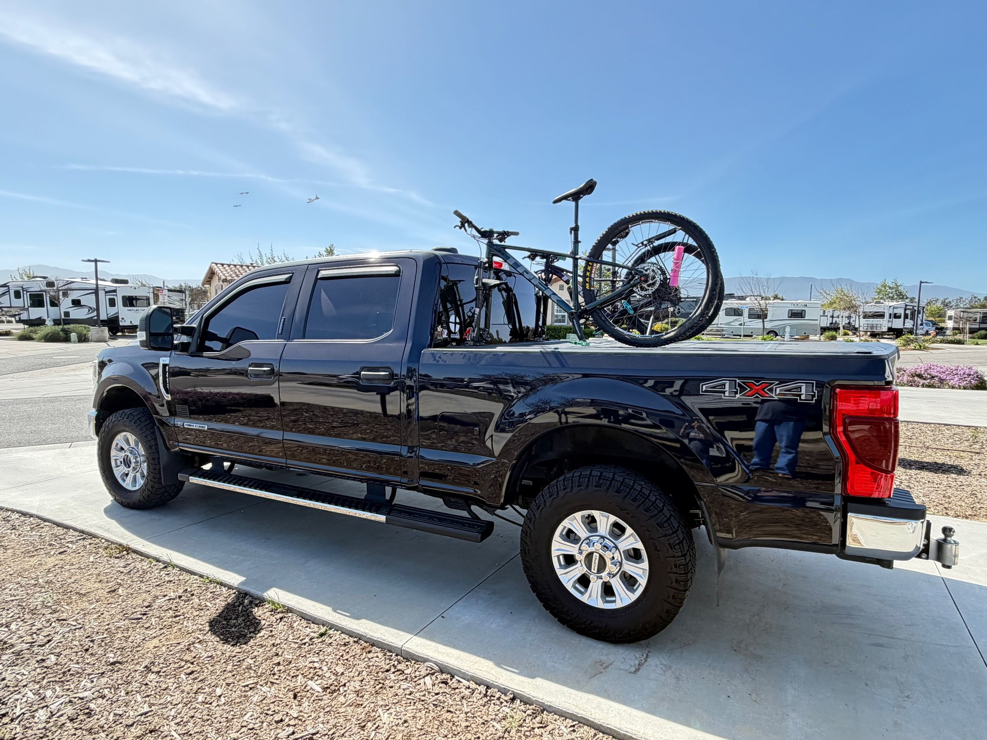

So I recently picked up a couple of bicycle fork mounts to mount to my tonneau cover, a Backflip MX4 (off topic, but I wouldn't recommend this cover... but it's what I got...) to carry my bikes. My other option is to use my front hitch, but I don't care to travel long distance with the bikes mounted up front... and for longer trips I will likely start carrying my generator up front anyway. So, the mounts came in and they mounted up pretty nice to my cover. I threw the bikes up there and they are quite steady. I don't really think they will go anywhere, but I still wanted to secure the back wheels to keep them from sliding around on longer trips.

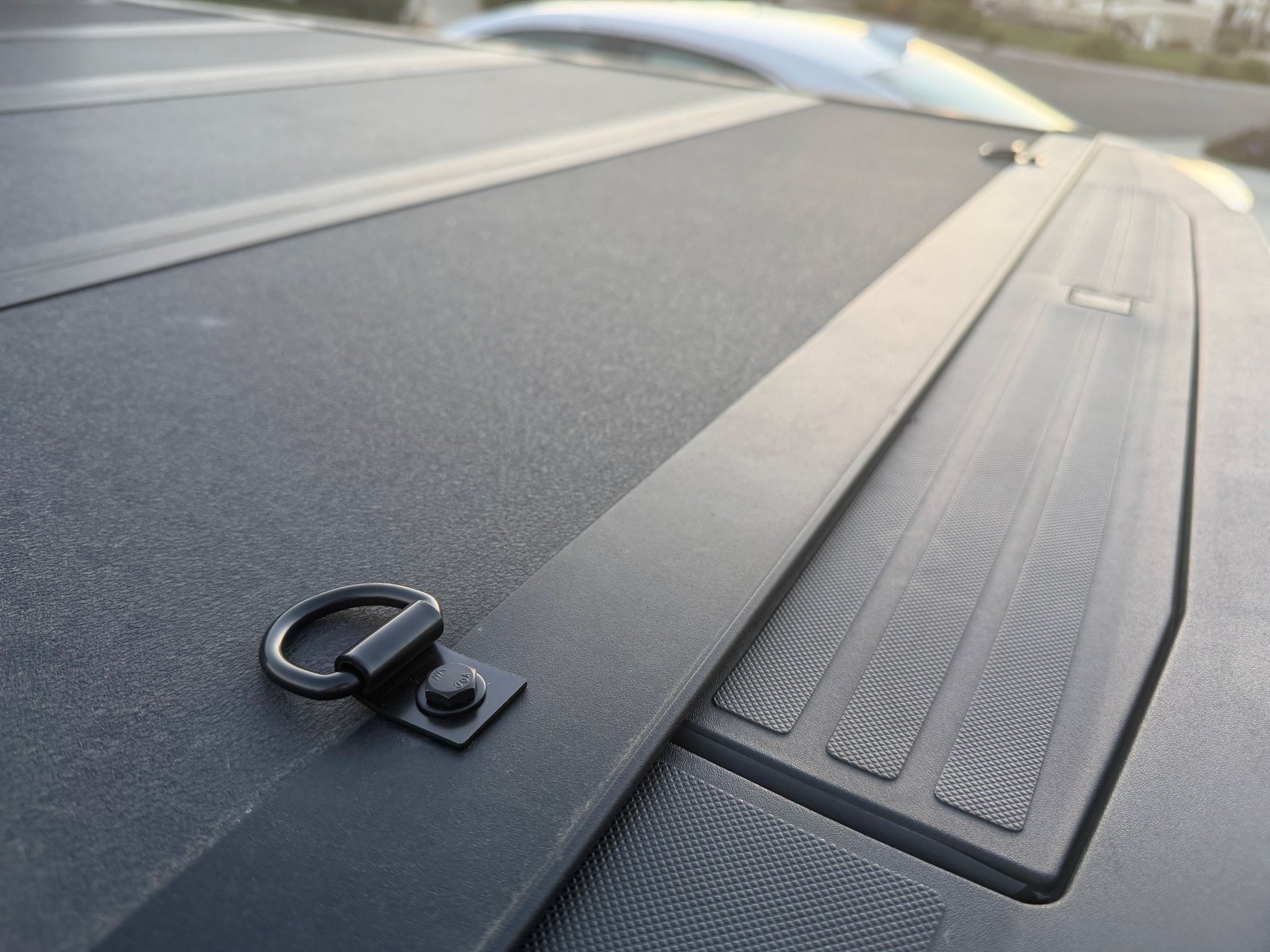

When mounting these items to the cover my goal is to be able to just leave them in place. The fork mounts fit perfectly so I can still fold the cover all the way up without it hitting the mounts. So for the back wheels I figured I would just mount a couple of D Rings since they have such a low profile and would allow me to fold up the cover. They came in today and I got them mounted on and they throned out as expected. I can still fold the cover up like they aren't even there...
However, I ran into a snag. The D Rings have no retention so they flop around, which is fine for my use. However, when I fold the first section over the D Rings will hang straight down like legs, and the fold will stand up on the D Rings instead of laying flat. I would be ok with this, but I already see a couple of dents that they are putting in the cover when folding it over. On a quality cover this wouldn't be an issue, but this is the MX4... I would expect that on a short amount of time it would actually put holes in the cover... So, I need to figure out some way to keep the D Rings laying down flush so that when I am folding the cover open they stay in place. just trying to figure out some way to keep them flat that also has a low profile and will allow the cover to fold over, but will also last long term being that the truck lives outdoors.

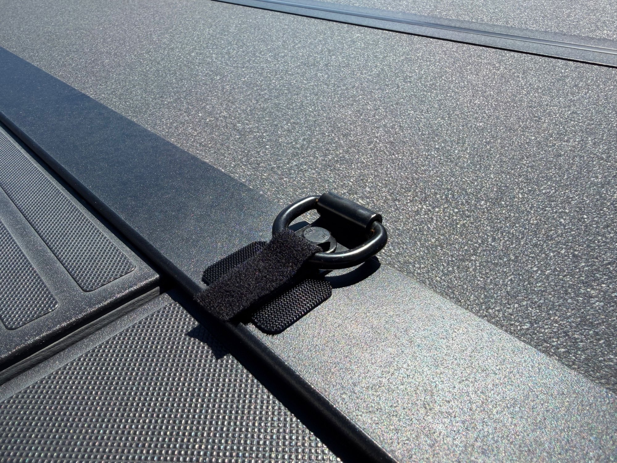

Just to bring this thread back around... I ordered some of those sticky velcro strips that @JoeUser suggested. They came in today and they were an easy install that I think will work very well! Being that the velcro strap is looped around the hook it will even keep the metal loop from hitting the tonneau cover and will actually cushion it! I think the sticky part is going to hold well since I won't really be using the hooks often, and I figure the sun will heat it up and the glue will adhere well... Anyway, here's a photo.
