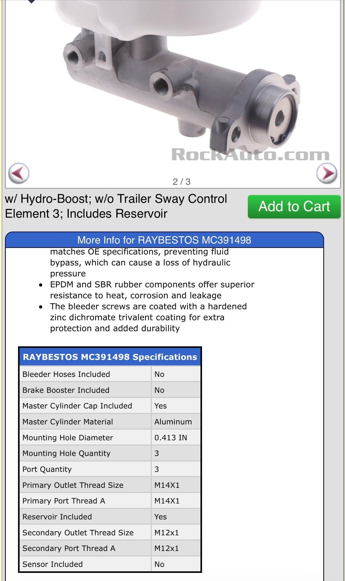

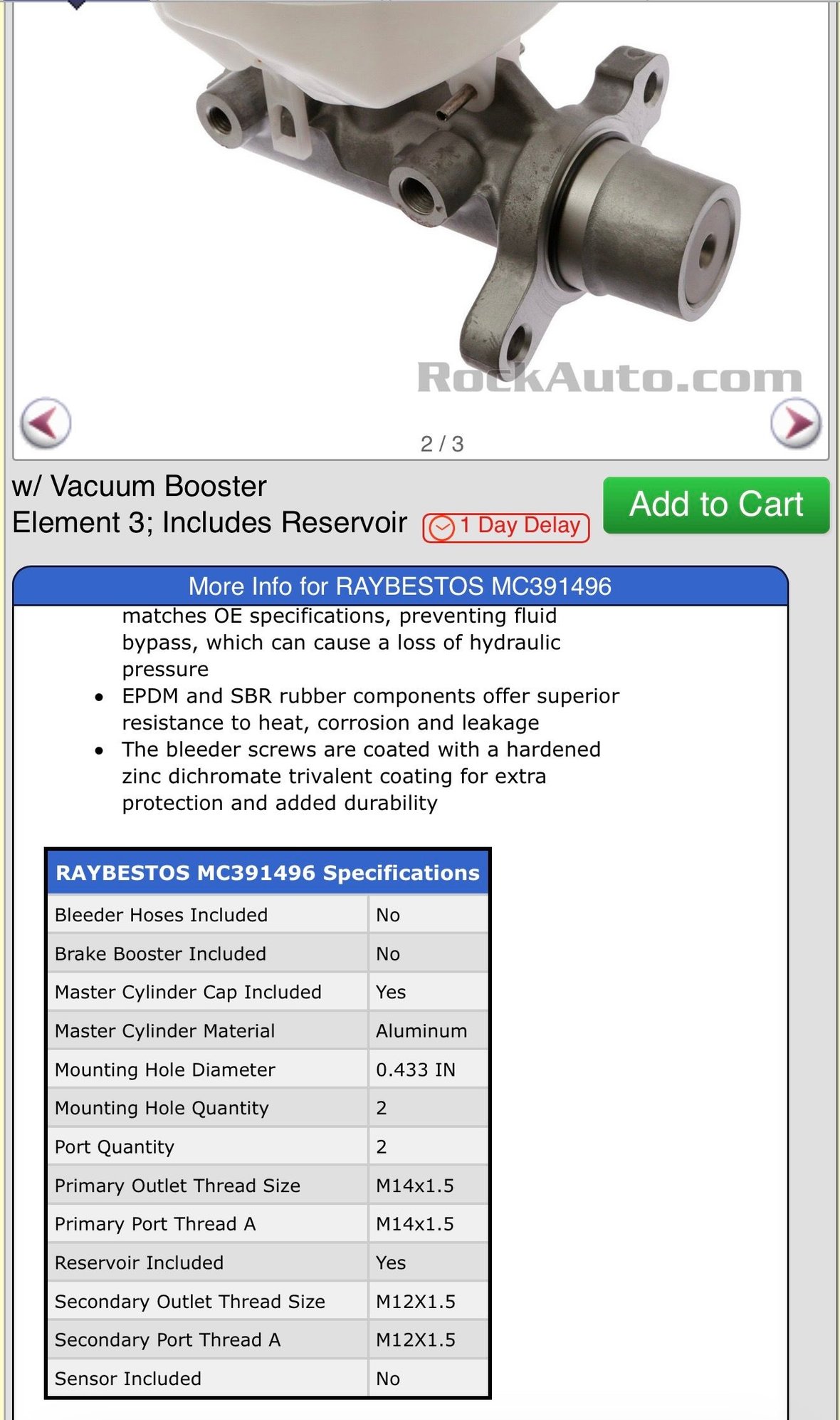

Not sure if this helps

Yes that very much helps! Mine is vacuum boost so its the m14x1.5 & m12x1.5. Whats the best way to go about plugging these ports? As its flare I cant run a normal bolt through it. I thought about getting 2 brake fitting with a line and crimp the lines. Doubt I will get it completely sealed though
