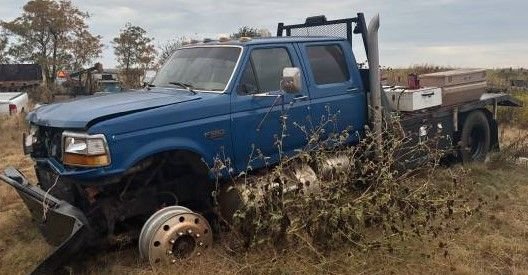

Old Dec 9, 2025 | 10:36 PM
JerryWieland's Avatar
JerryWieland
Joined: Jun 2007
Posts: 42
This is the truck in question. Has F350 emblems on the fenders.
Old Dec 9, 2025 | 10:39 PM
85e150's Avatar
85e150
Joined: Apr 2004
Posts: 34,475
Likes: 2,800
What does the sticker on the valve cover say?
Old Dec 9, 2025 | 11:09 PM
Prototypemech's Avatar
Prototypemech
Joined: Nov 2013
Posts: 3,922
Likes: 1,192
From: Mojave, Ca
The pitman arm and front wheel tells me that's a medium duty frame (20,000-30,000 lb class rating) with a f350 (10,000 lb class rating) cab and fenders bolted to it.
Old Dec 10, 2025 | 01:47 AM
JerryWieland
Joined: Jun 2007
Posts: 42
Sadly I have gotten no response out of the seller and he is a few hundred miles away. It looks to me to be a homemade oil field service truck with an F350 cab. I think the engine is an English built turbo Ford of 495 cubic inches.
Old Dec 10, 2025 | 01:48 AM
JerryWieland
Joined: Jun 2007
Posts: 42
That is my thought as well but I cannot get the seller to respond.
Old Dec 10, 2025 | 02:17 AM
85e150's Avatar
85e150
Joined: Apr 2004
Posts: 34,475
Likes: 2,800
Are you really interested in that?
Looks like junk to me.
Truck Trader is full of running, serviceable ready to work trucks
Why buy an unfinished questionable project?
Old Dec 10, 2025 | 02:25 AM
JerryWieland
Joined: Jun 2007
Posts: 42
If the engine is what I think it is I need it. I need to do more research on it. Thanks and being a junk pile might work to my benefit. I am not much for buying others finished projects anyway.
Old Dec 10, 2025 | 02:32 AM
85e150's Avatar
85e150
Joined: Apr 2004
Posts: 34,475
Likes: 2,800
As a parts donor it might make sense if it's a runner. Good luck on getting the seller to wake up!
