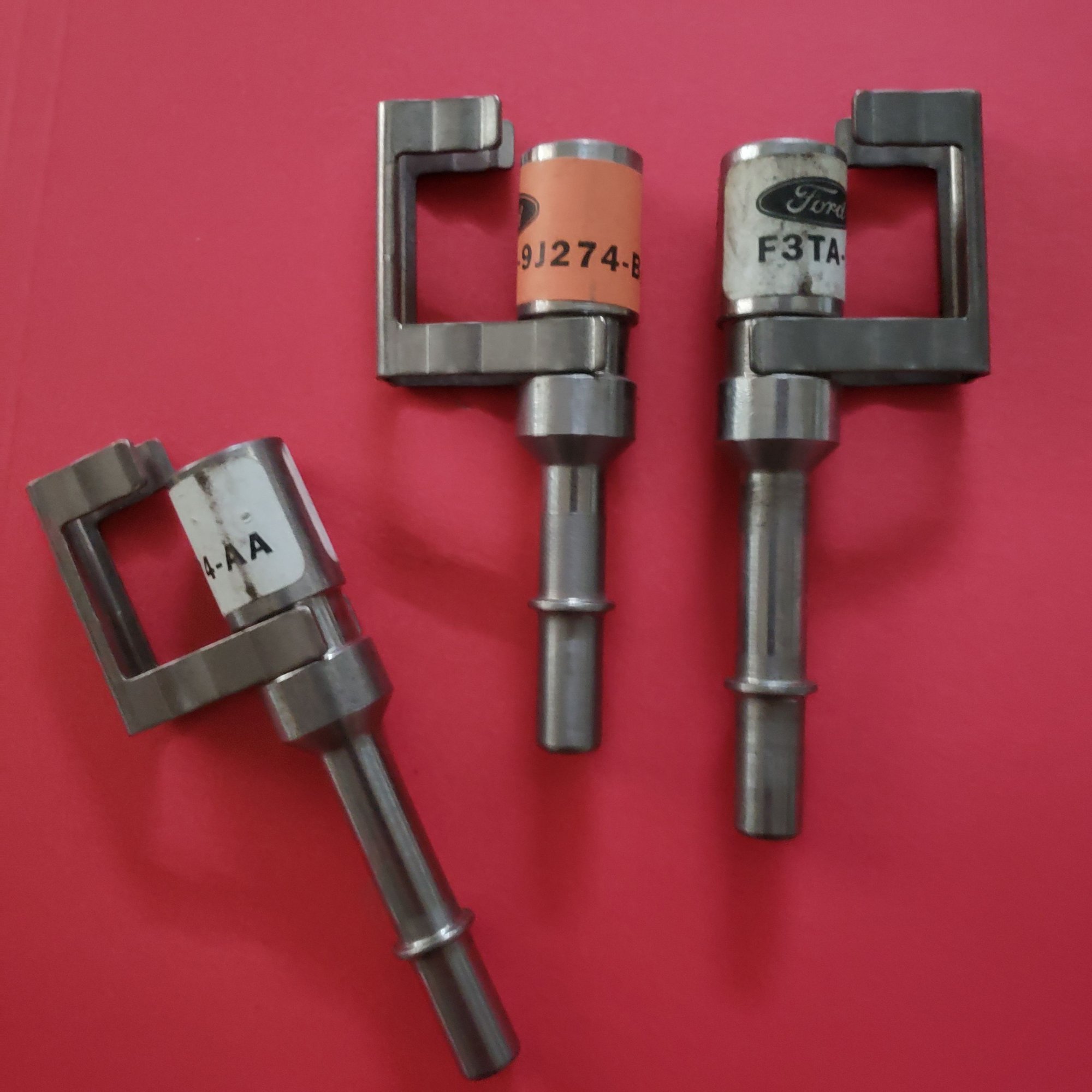

There are actually 2 check valves in the pump assemblies and some have a pulse damper too
I have found after replacing 3 pumps min less than a year in my last 04, the recall check valves are the answer
Otherwise, put a zipper on the fuel pump
I put a zipper in my 94 van, now I can change the pump in 10 minutes from inside the van
I post pictures of these recall check valves often
I used to have a bunch of 'em
These are my last ones, if you come mow my lawn once a week, all next summer, I'll give you ONE
We just called them one way valves. the longer ones are for the metal fuel lines like the 1995's have that need the special tool to remove

One of those recall check valves will fix it forever, (better yet, two valves if dual tanks)
Even the ones I see at the junkyard that are so rusty, you can't get them off, still work.
I can't be the only Ford boy with a few of these in my toolbox
You guys should check a few of the Mustang sites for seasoned Ford (master) techs and ask if anybody has any check valves
I used to give my extras away
Any Ford tech old enough to have dealt with those valves at the dealer is about ready to give it up
Means they should be about ready to part with their spare parts
