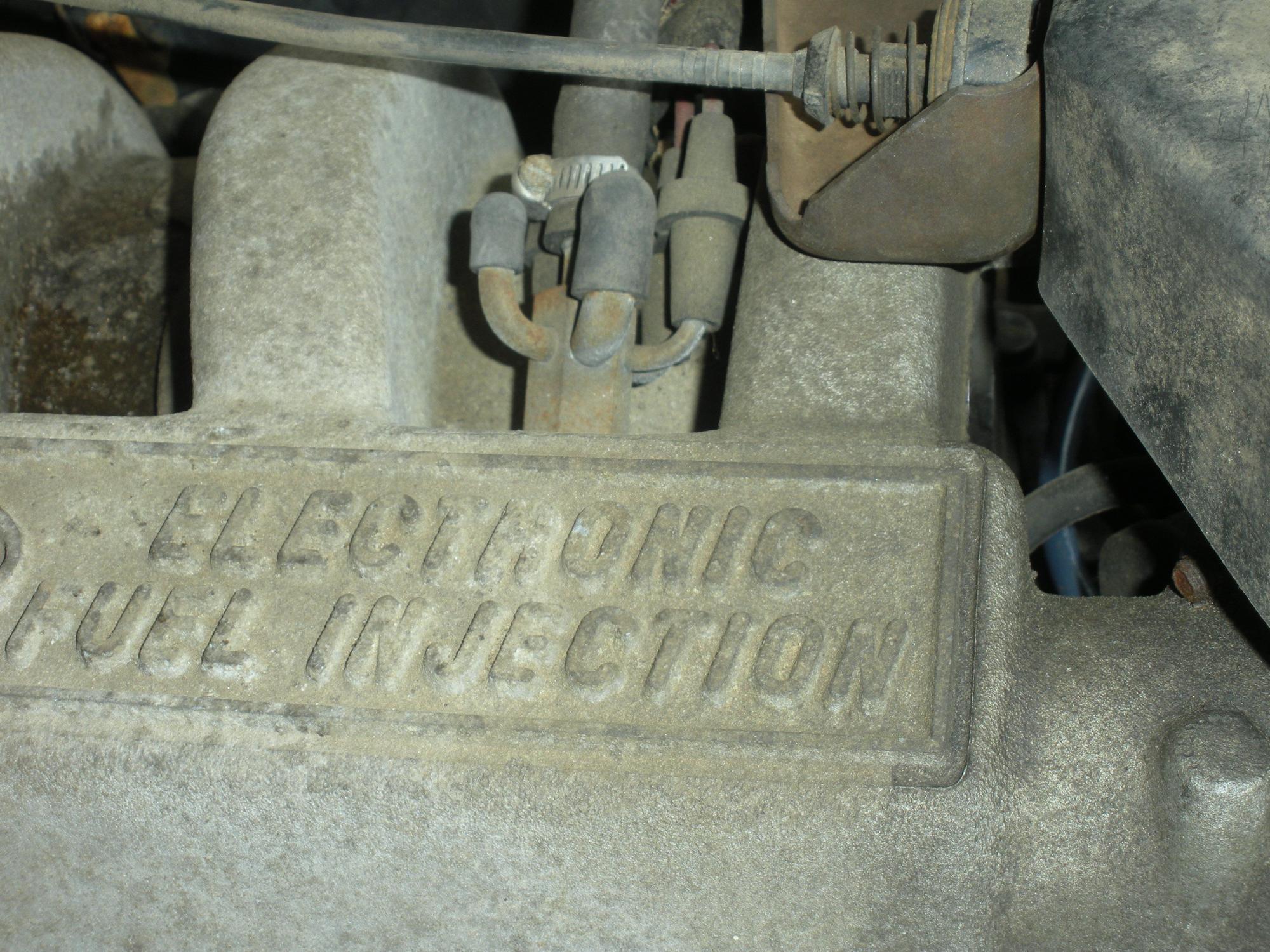

I see that intake air temp is in #5 intake runner...I wonder if that's bad would it somehow make the other side run rich ?
For what it's worth, I seem to recall when I put new terminals on the coil connectors, a lot of nagging stuff went away. They were pretty bad.
I guess what I'm getting at, is corrosion can cause issues.

Sometimes underhood pictures get complicated. I do not know why the OEM's have to be so messy with their underhood routing. Someone must have complained, you will notice now most cars and trucks have a large plastic cover that just covers the mess up.

Just so you know, a few years after taking that picture, I wipe some of the oily gunk off the valve cover. My thought is oily gunk won't rust.

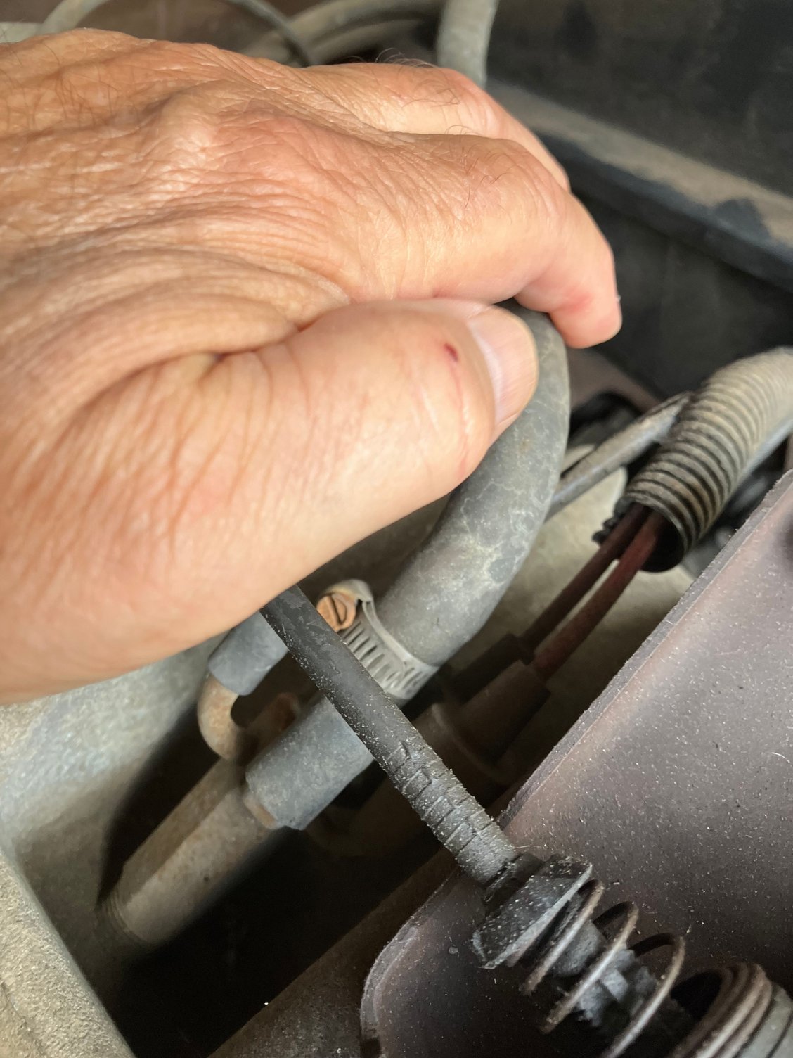

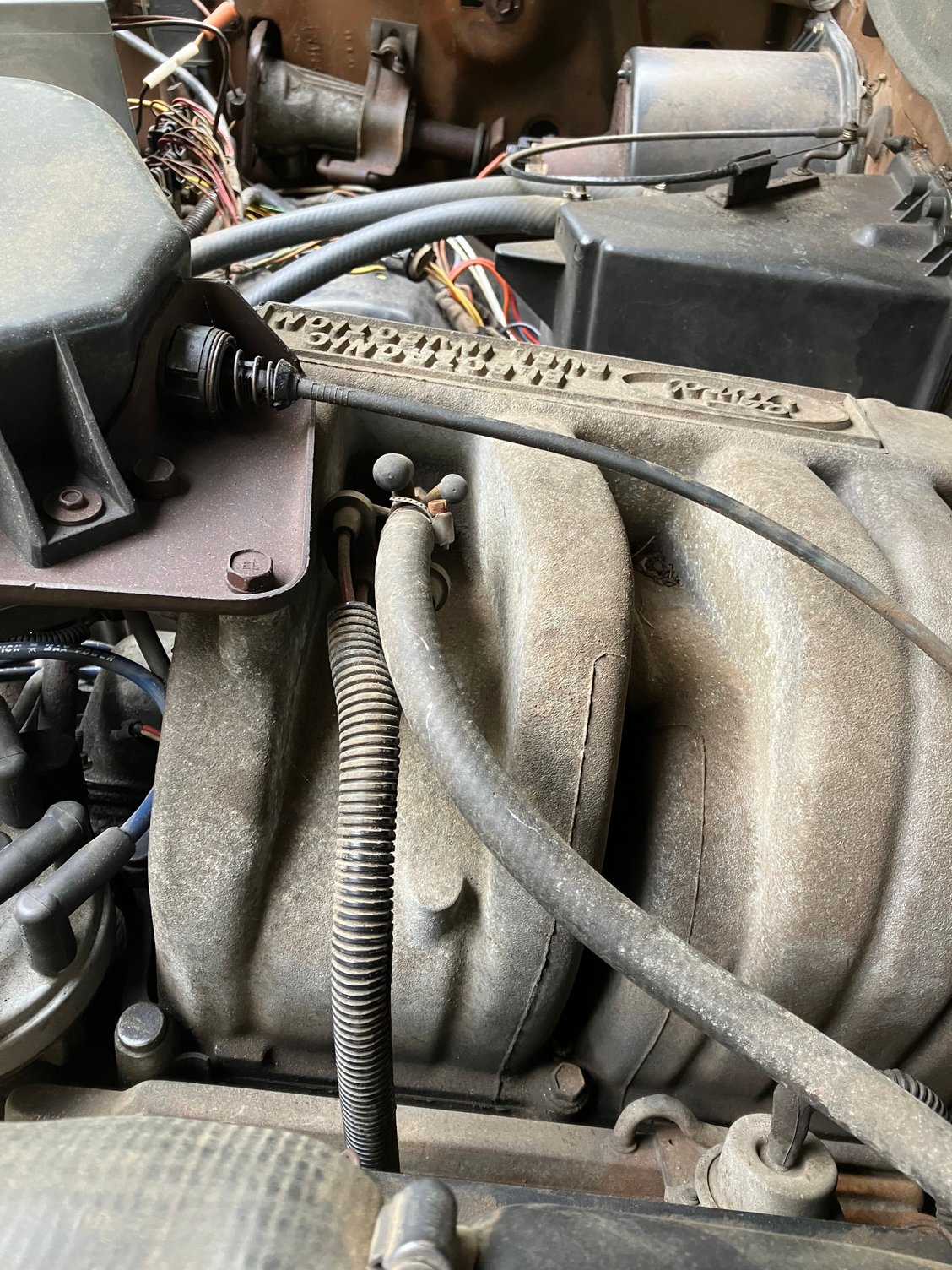

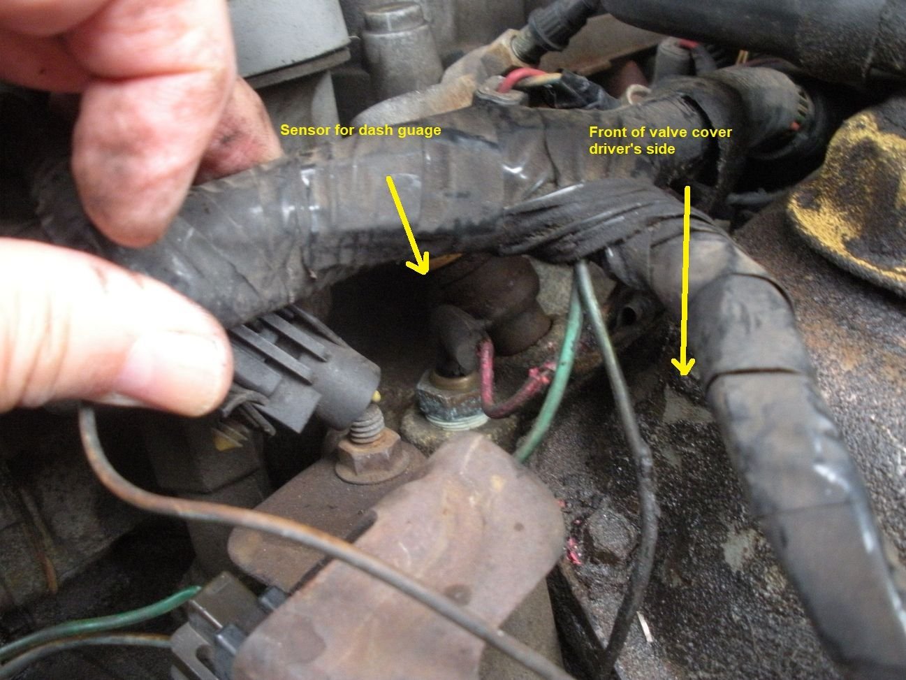

Went out and got more pictures, also, make sure you have the connector plugged in well on the MAP. But I'm sure you've gone back over all the things you touched.
Looks like I have lines coming off the vacuum tree. The fourth one is kind of hard to see. I pulled back the brake booster hose to show it.

Some of those vacuum lines from the T go to this vacuum box near the battery. See the red and black vacuum lines in the upper left in picture. Some guy's have removed some of the sensors on the bottom of that box. Dave may know more about those, I know someone on here talked about a while back. I didn't pay much attention, as I have no need to change any of that.

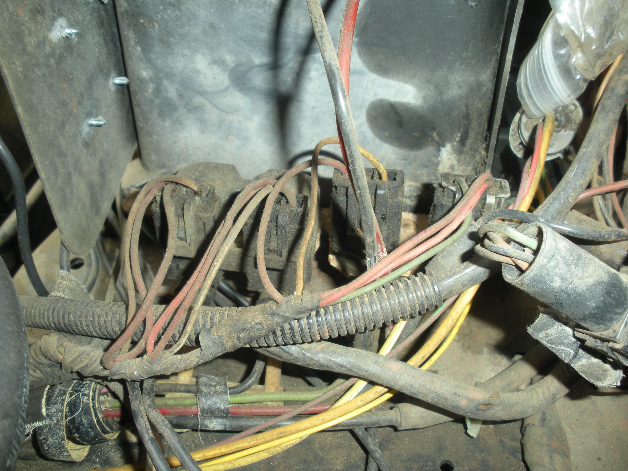

I know about the black box. Lost spark a little bit ago when I was messing with it and that red line had slipped out. Also the four connectors under the thing. What are those for? I thought those were supposed to be jumped together because I couldn't figure out how where they were supposed to be ran. I'll get a picture to show my attempt at redoing this wiring with a guess and a prayer here in a little while.
