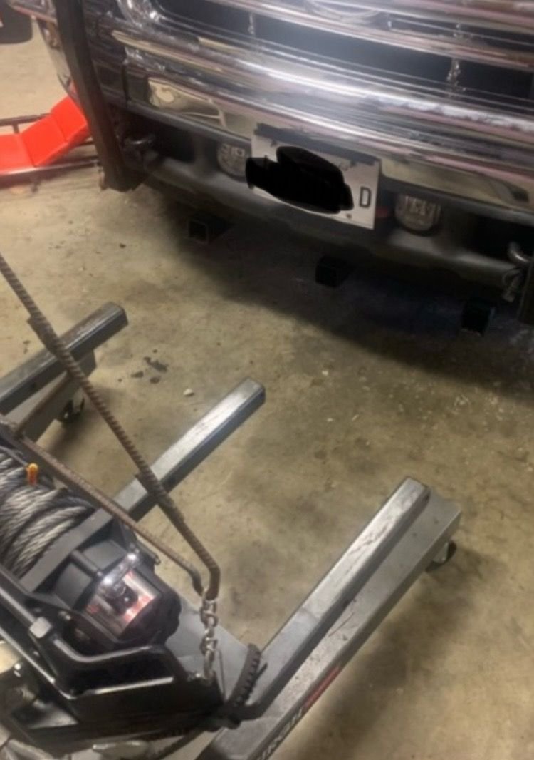

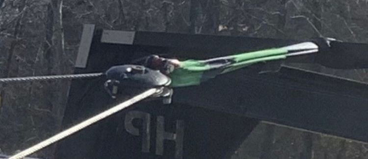

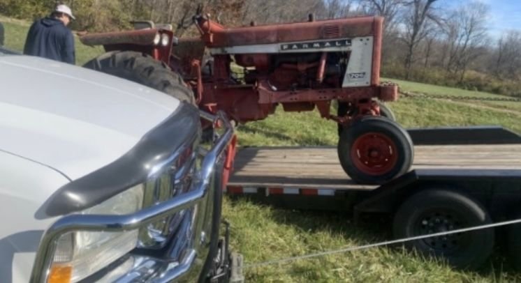

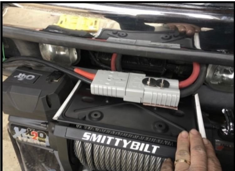

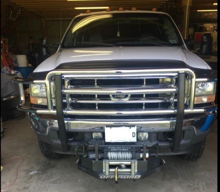

I’ve got the Smittybilt X20 17,500 lb winch and love it. I use it for farm use, pulling out trees into clearings for firewood, and recovery of other vehicles…… so I’ve got the 1/2” steel cable…..no synthetic for me.
Made it quick connect so that it’s removable when I am running around town. The winch has wired and wireless remote and I also wired a plug into the winch controller and toggle switches on my dash so that I can easily control from the cab without holding a remote control in my hand.

Hard wired in cab controls are very nice. So is a wireless controller.

^^^^^^^ Except you forgot a few things 🙂
Your putting a large winch on the front of an axle that is almost at it GAWR because of the 7.3 engine and 4 WD
All of my work is custom, nowhere did I say a single tube receiver with minimal weight rating
I am a 63 year old boilermaker welder ( still working)
My plugs iins are custom and are hidden thanks to a 1969 chevelle rear license plate holder. I can also plug in my 30’ heavy duty jumper cables.
And any time I think I might need it I can install it easily with hitch pins and lockable.

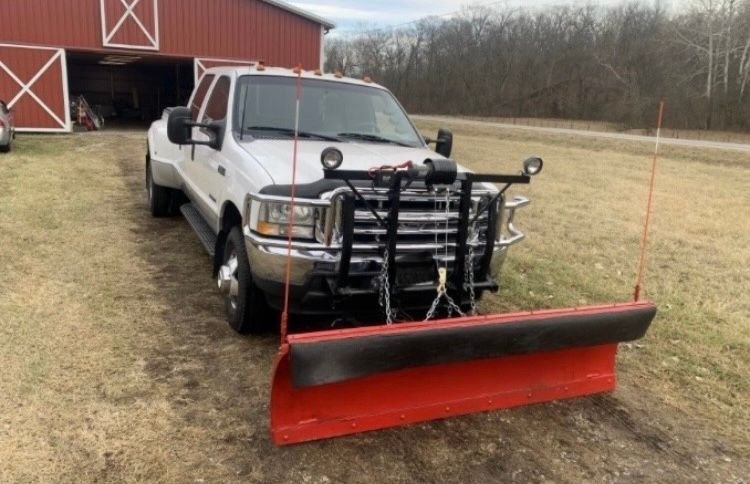

And I can remove my winch and install my customized 7.5 fisher snowplow👍
