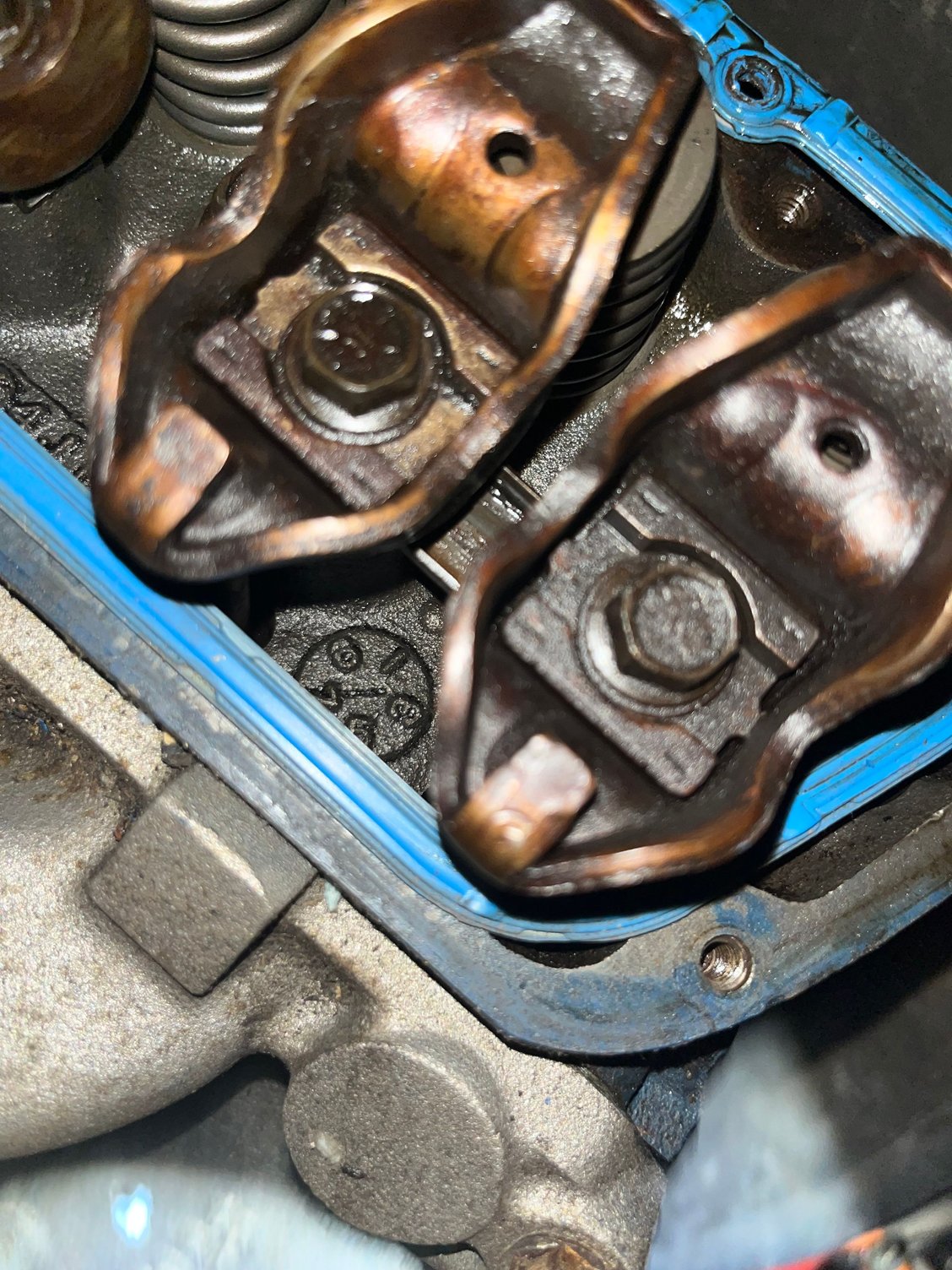

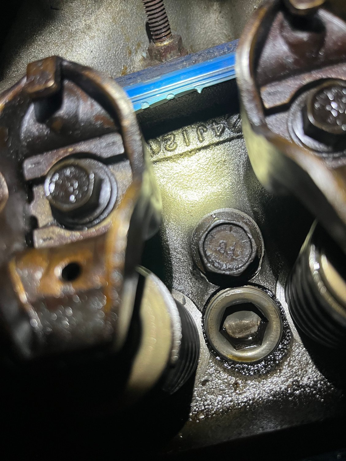

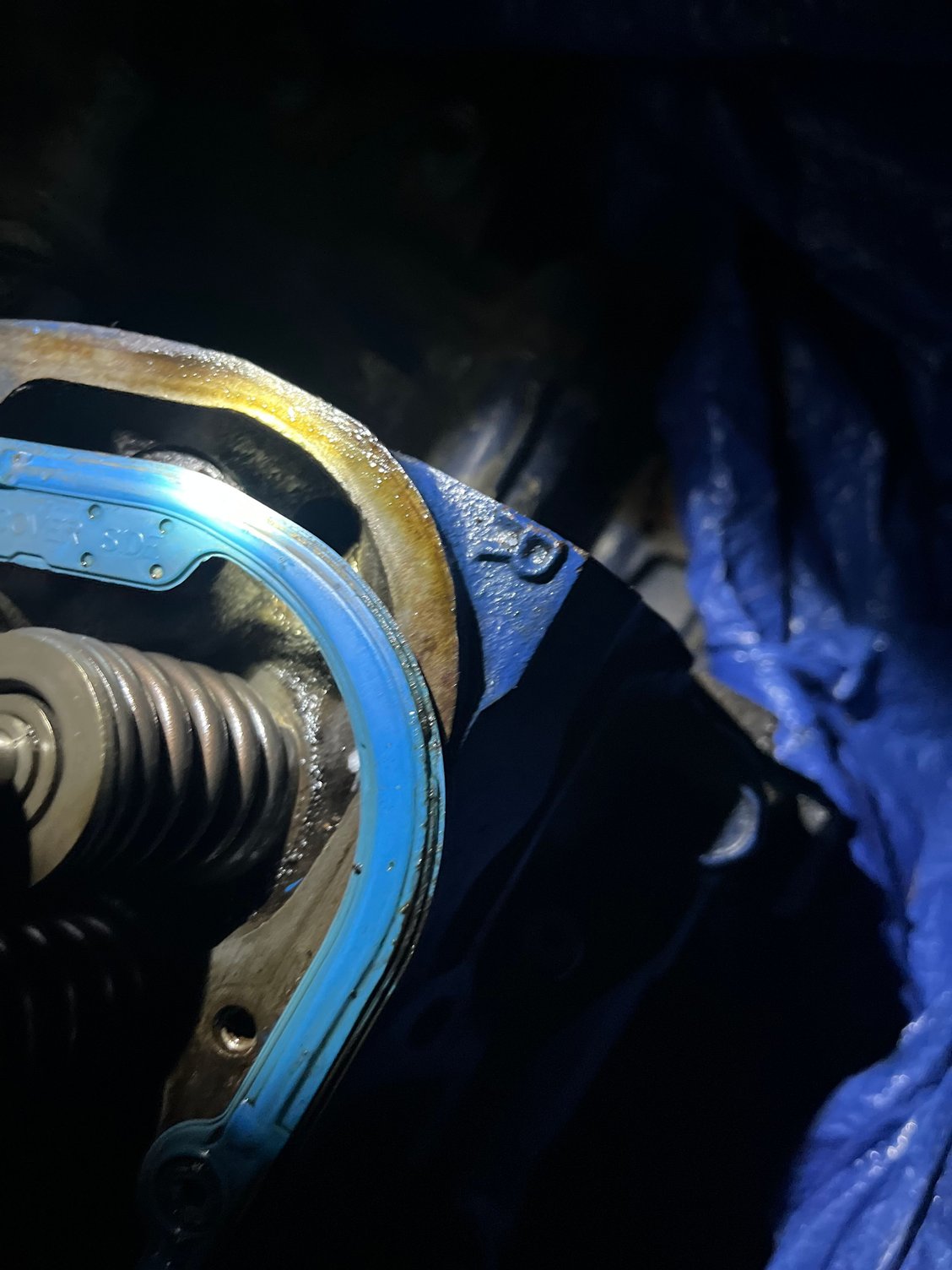

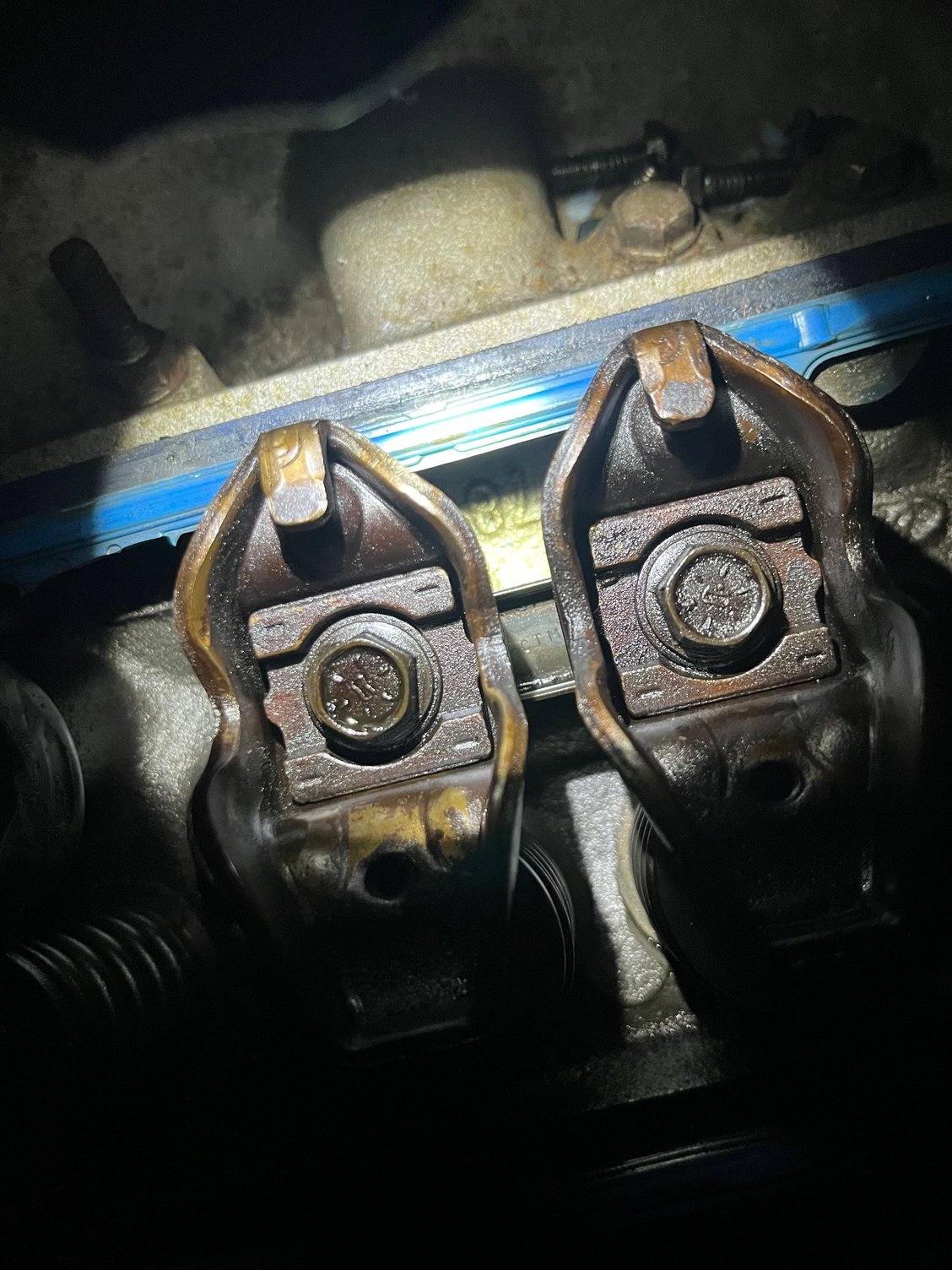

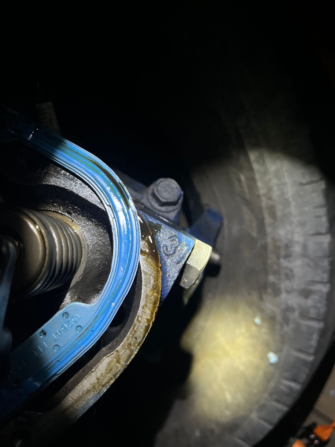

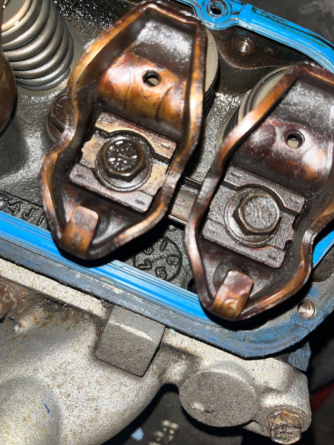

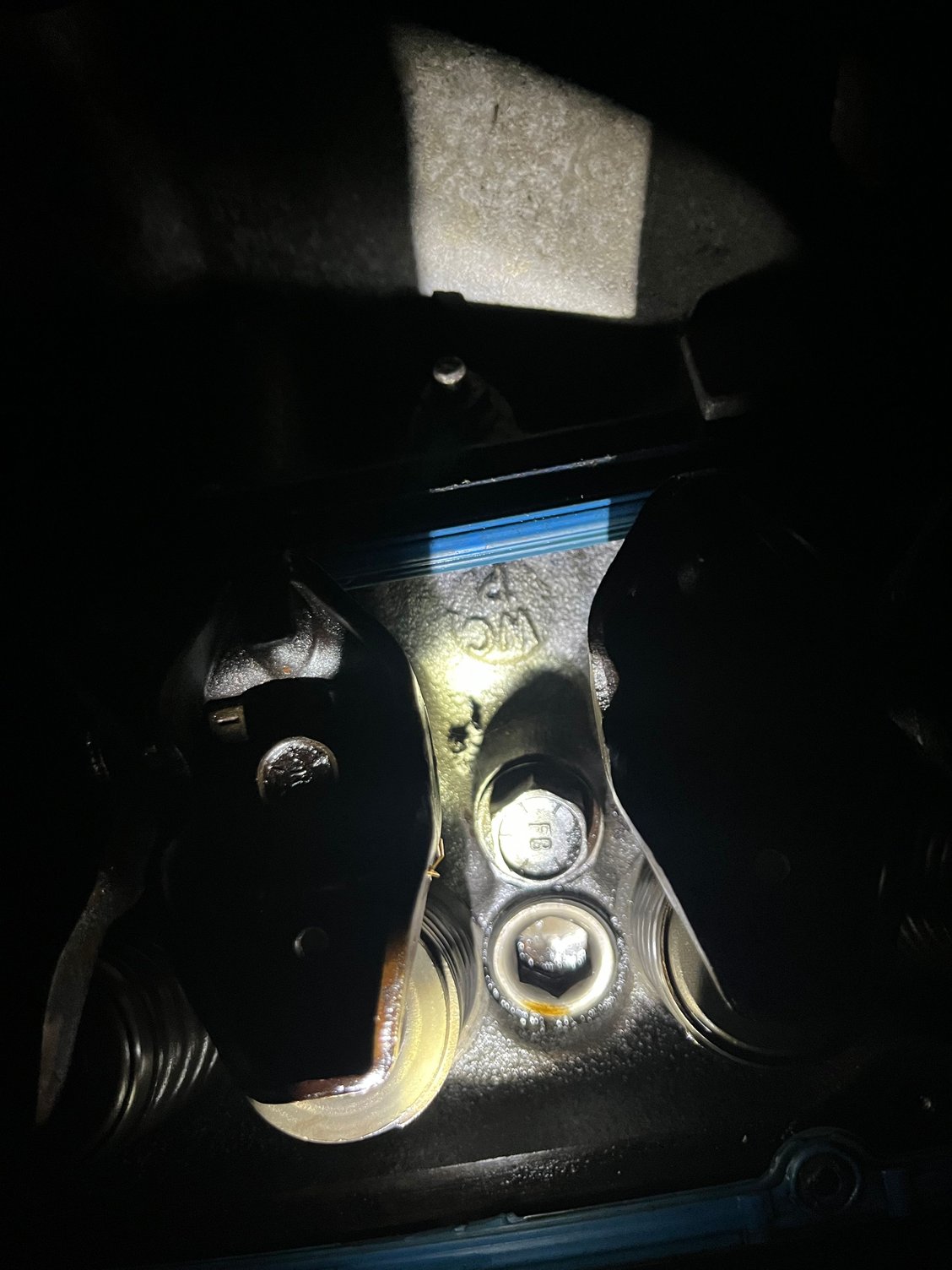

Can anyone identify what heads these are?

R = E5TE.. same as the E7TE except larger combustion chambers,

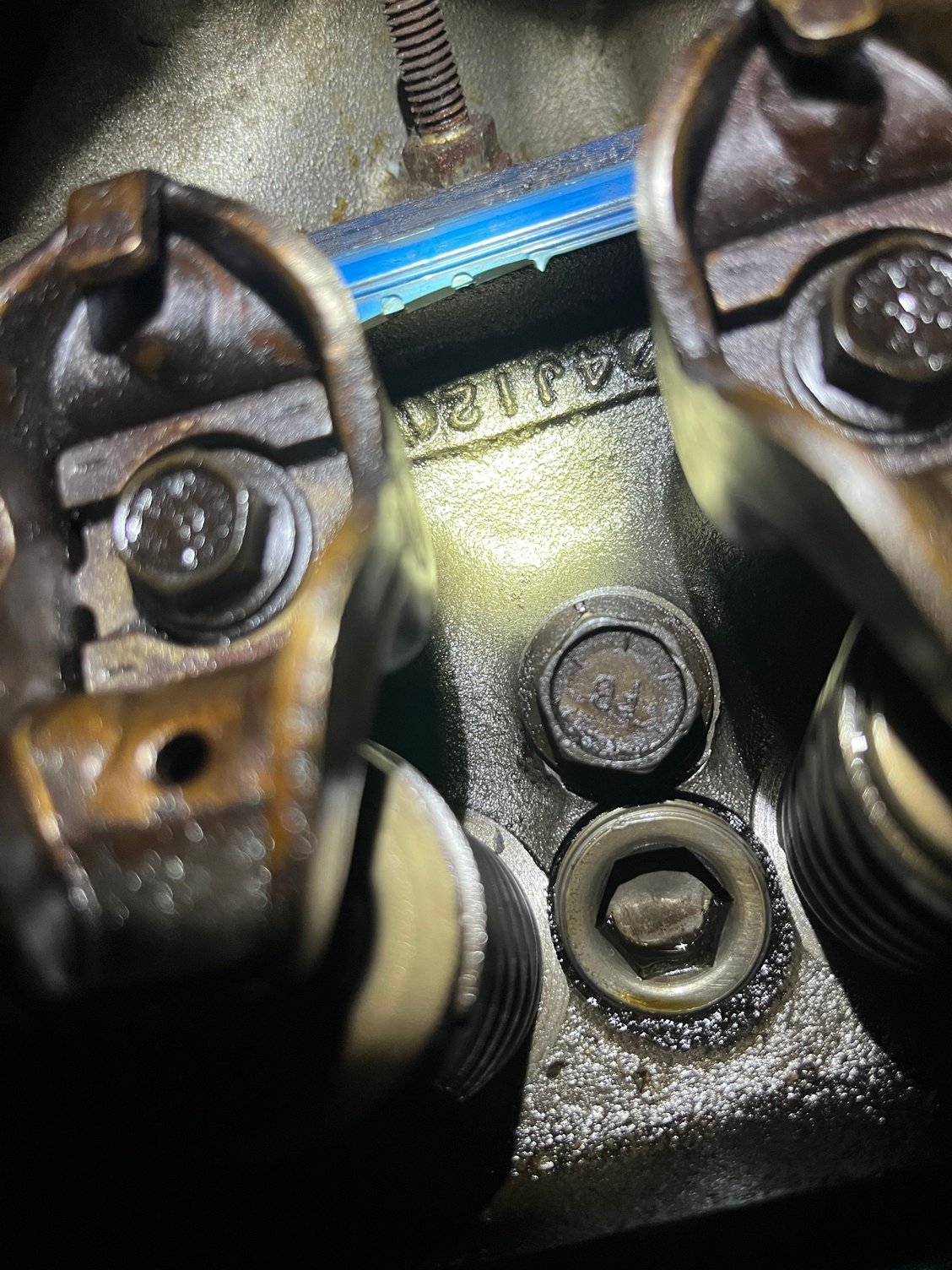

4J12 is the casting DATE. 4= year ending in 4 (could be '74, 84, 94, etc), J=month (A=Jan, B=Feb, etc) but no letter 'I', so K=October, 12 day of the moth. SO those heads were CAST on Oct 12, 19x4
WCP is Windsor (Ontario Canada) casting plant.
