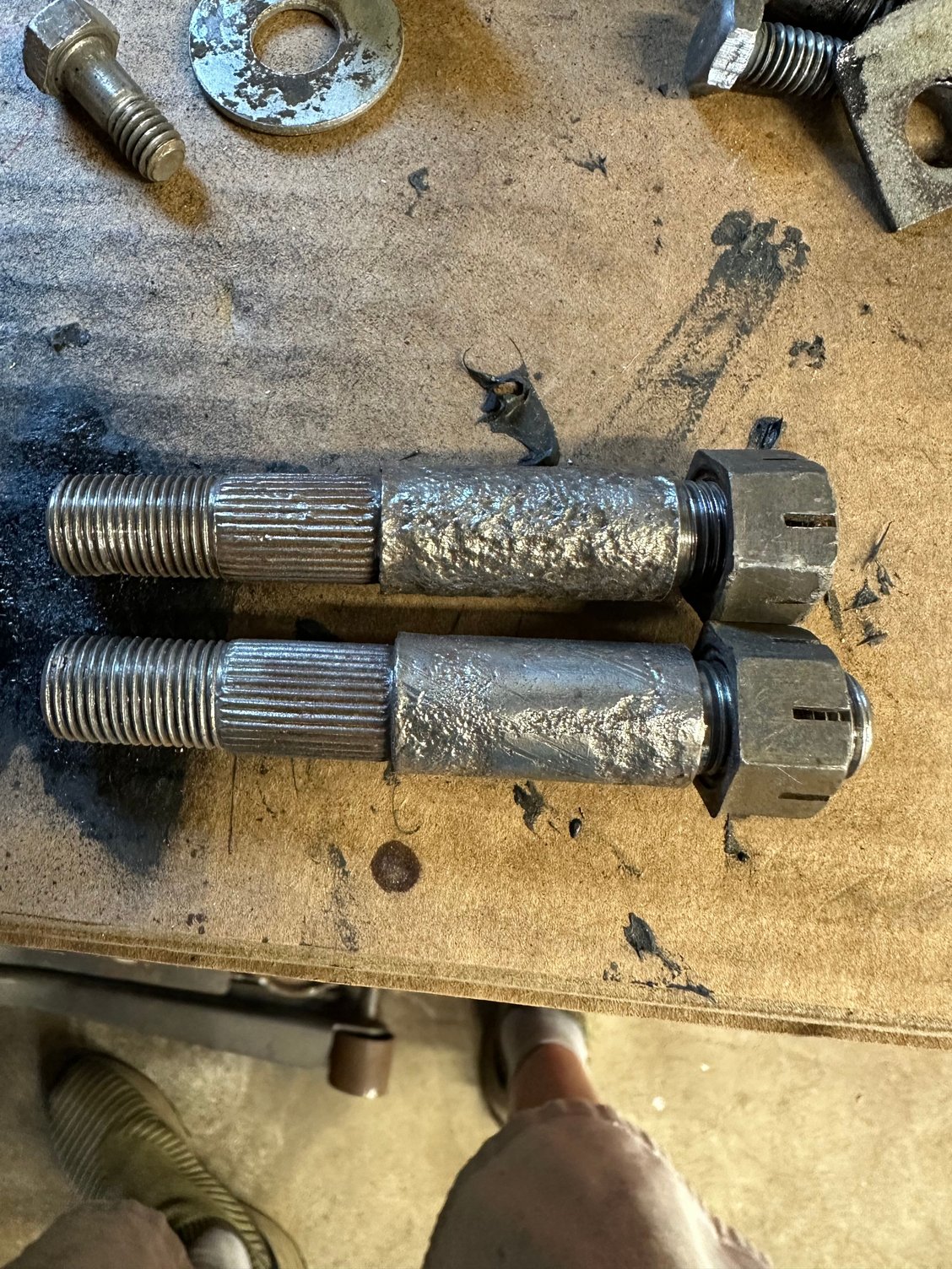

I found these. I think they are correct but take a closer look. They may be the lowers. I cleaned them up in rust 911 and there is some pitting. If you put it in a drill press with some emery cloth you can knock the high spots off. If you don't have one and it will fit in my chuck I can do it. Let me know and I can send them to you. If you are using a shock without a sleeve in the bushing or replace it with a straight rubber busing you should be line. The sleeve might be fine as well, I just don't know if it might be a little loose fitting.
