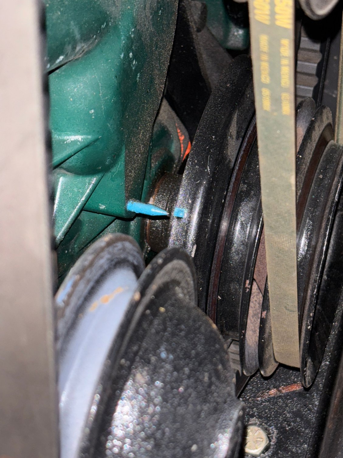

1953 239 Flathead V8. I see the timing should be 2° BTDC but there are no degree marks. I feel like I read somewhere that the timing bump is at the proper setting when aligned with the pointer. Hep me out please. I've got them painted light blue in the picture.
Thank you in advance.

You simply line the pointer and bump up for initial timing.

Make sure that you disconnect and plug the vacuum advance while setting the timing.
