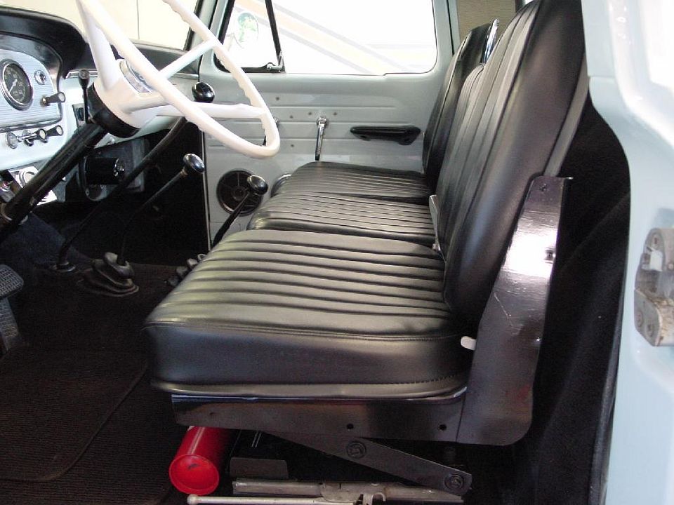

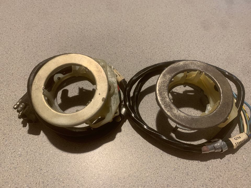

I made up a little cheat sheet of the numbers - if superseded I gave as many of the numbers for a given item as I could find. The turn signal and horn wiring goes down the left outside of the steering column with a clip around the steering column that holds a cover on. You can sort of make it out in the picture above of the truck interior. I can take a better picture of that if you want. Perhaps you already have some of this stuff, but I wanted to document as much as possible here.
C0KF-13305-AP - Turn indicator lever assembly - black ****
C1TF-13341-D/C1TF-13341-K/C2TZ-13341-D - Turn indicator and horn contact plate assembly
C3TZ-13376-A - Turn indicator switch wiring cover
C2TZ-13377-B/C7TZ-13377-A - Turn indicator cover clip
C1TZ-13A805-C/C1TZ-13A805-D - Horn button or C2TZ-13A805-A Horn ring assembly (each is made up of a few individual parts)
C1TZ-13A807-B - Horn button blowing spring or C1TF-13A807-A/C1TZ-13A807-A Horn ring blowing spring
C0AF-13A821-A - Horn blowing brush
C1TF-13A822-A - Horn blowing brush insulator
C1TF-13A832-A/C6TZ-13A832-A - Horn blowing ring contact plate (Not used when equipped with turn indicators 13341)
They also had kits that included the turn signal switch (with horn contact plate) and harness, turn lever, bulbs and small hardware for a dealership/mechanic or owner to add turn signals to a truck that didn't come with them.
