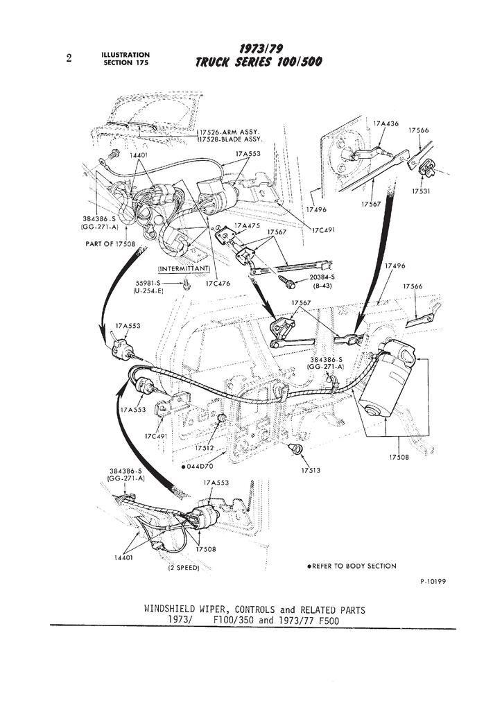

A good repop can sort of be hard to locate. I remember a thread that talks about a easy aquired cheaper diifferent appliciation (like a Dodge) and it is the same set up. Looking for that thread. And in the mean time repop parts sources.

It is kinda back/up in there for sure. Better build one of these.

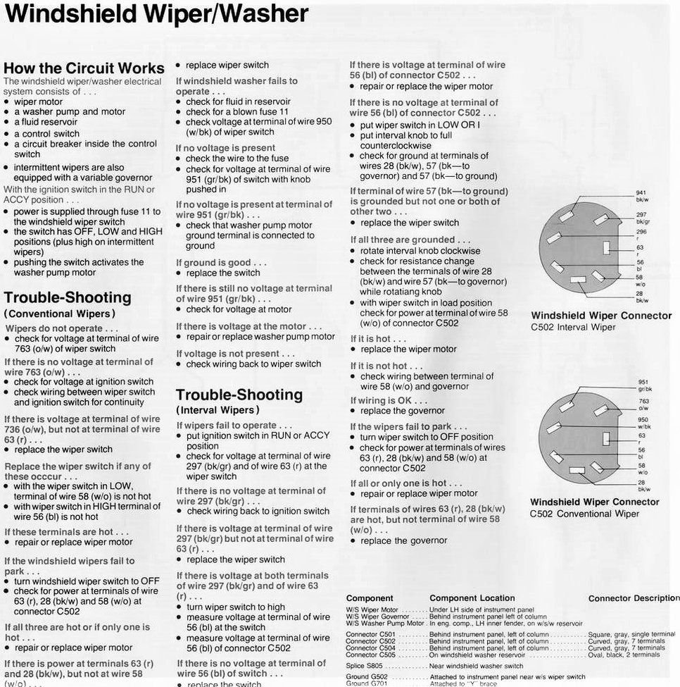

Hopefully its just a simple fix like a fuse, disconnect clean and reconnect the main elec connector. Or maybe just a wiper switch replacement.

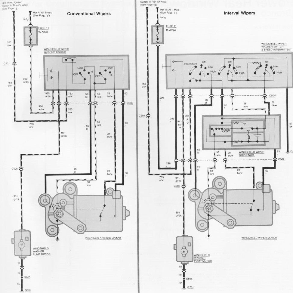

The Wiper Washer works off the Backup Light fuse so your washer pump can still work but the wipers may not.

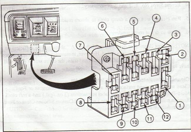

Start with fuse for wipers, if it's good, check for V and corrosion at the fuse block, good 12V no gunk, move up to wiper switch, check wires along the way, remove wiper switch, check conx for goo/corrosion, if found, clean off, if not, thanks to Rich's help, you can run a hot wire to wiper motor Low blade and see if it works...

i just inspected the fuse. The little wire on the inside looks white. But still one piece. Im guessing thats not good.
also where can i find a nice fuse kit?
update:
i just messed around with the fuses. The switch is making a "tick tick tick" and same with the wiper motor. What does this mean? Is the switch shot?

not be be blunt, but you can't just guess that the fuse is bad...you need to test it will the continuity function of your multimeter. Rich posted step-by-step instructions on trouble shooting the issue, so there is no need for you to guess and especially nobody that isn't at the vehicle. The clicking sound is the circuit breaker opening and closing...could be several things that following the steps above will pinpoint the issue.
