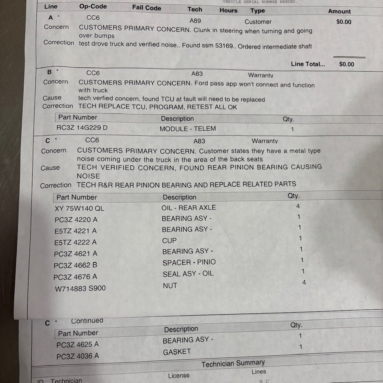

Ended up being the rear pinion bearing…at least that’s what the dealer says and they ordered a part.
they said it was pretty clear once they got it on the lift.

Old Jun 9, 2025 | 04:56 PM
WVMoose's Avatar
WVMoose
Joined: May 2025
Posts: 31
For anyone curious.
Noise is now gone.
