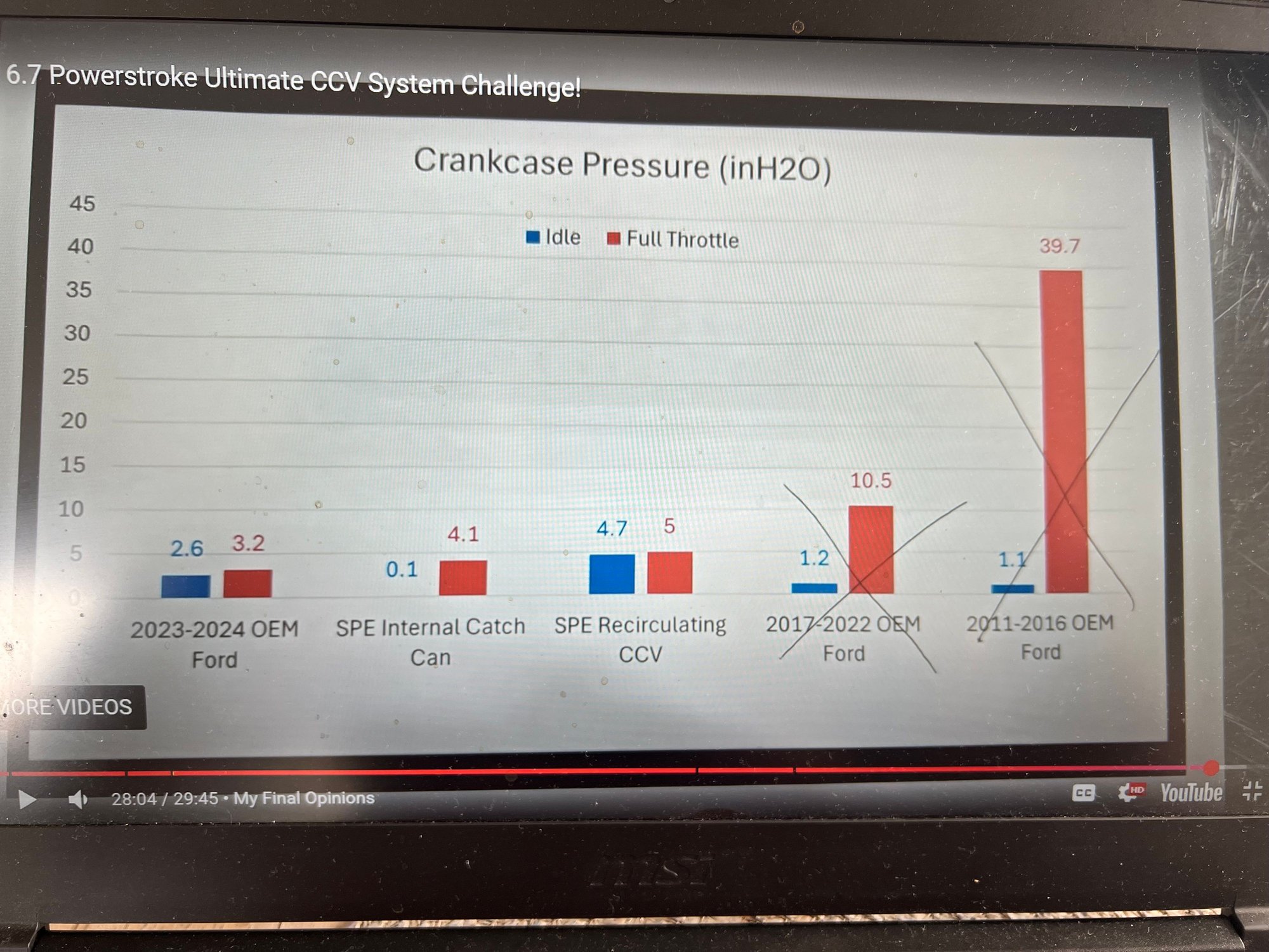

They sell delete kits for the CCV filter. I am not sure if this is where your problem originates from but when it comes time to replace mine, I will opt to install one of these kits. I think they are pretty simple, but I’m not sure it will fix your problem if it’s the upper oil pan. My Dad just had this work done on his truck, 2018 6.7L, upper oil pan leak fixed, and CCV filter replaced, 29 hours of labor, two weeks in the shop, $4600, covered by his extended warranty.

Old May 13, 2025 | 02:56 PM
CBEllis's Avatar
CBEllis
Joined: Dec 2012
Posts: 1,563
Likes: 534
From: DFW
^^ @speakerfritz okay - so what does this graph tell us?
