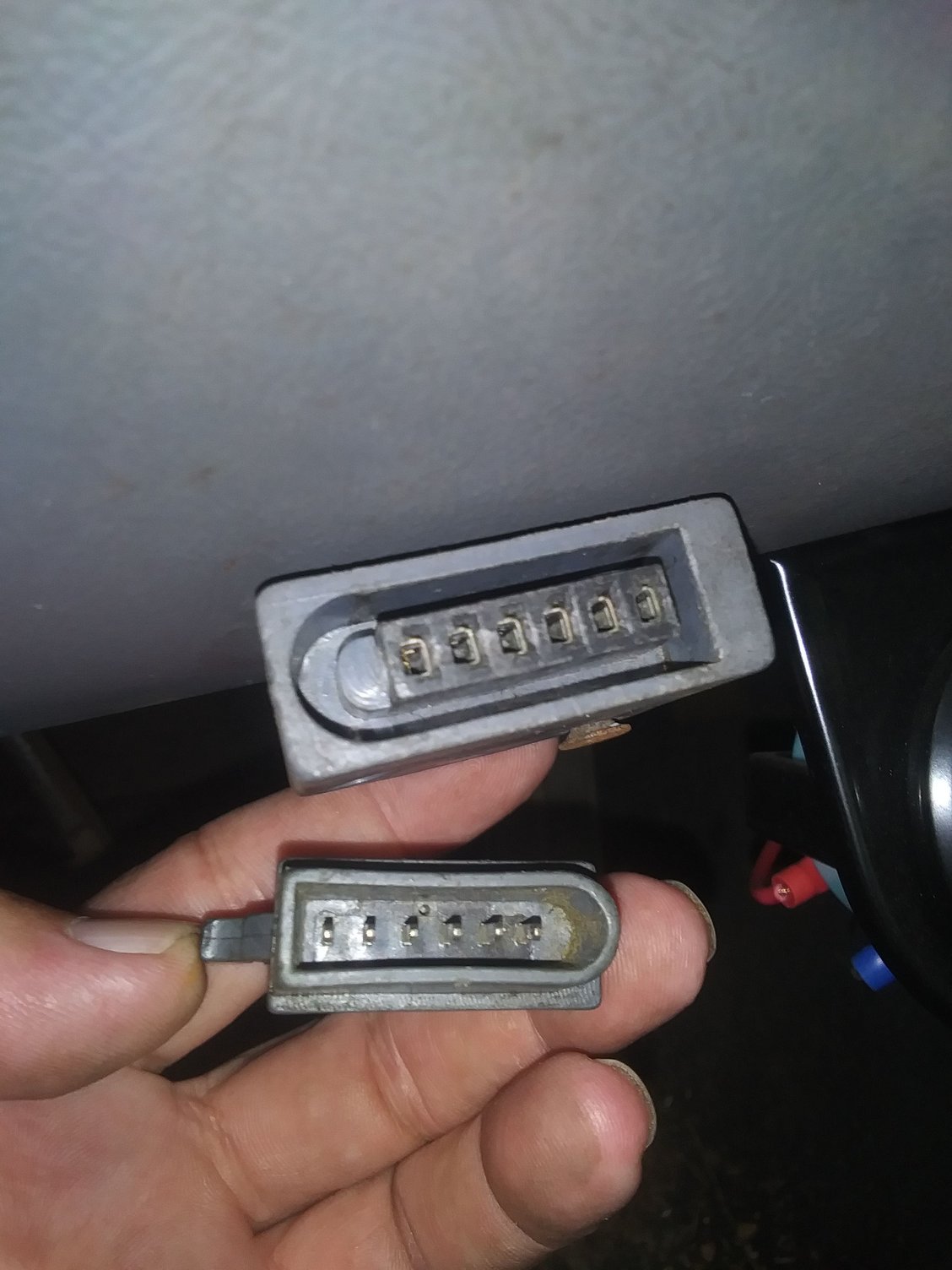

What is this?
What is this? It's on a 93 f150.
unplugged it makes no change in how it run. Can't see what it's wired into. Yellow red and Orange wires

OBD port with cover.....

Is that factory? I thought it was under the hood on these years.

Just a guess.
My Bronco is 200 miles away and I am fairly certain I have a port inside, it has been years since I have had to do any electronic troubleshooting on it. Dad drives it more than I do.
It may be an aftermarket tune port added. The screws do not look standard to Ford and show rust. Screws may have been replaced at some time and may be stock port...
Again just a guess.

Does not look like any OBD port I’m familiar with, and 1993 should be OBD with the connector under the hood on the left fender.
Possibly a security system. The part that detaches is a ‘card’ programmed to the system. You’ll have to trace the wiring back to where ever it goes. Possible it has been deactivated, and just left there. Also possible it will not start with the card removed, but will run if the card is removed while running.
There is another thread on here with a similar system.
No.
That is what it looks like to me.

You are right it will not run with it unplugged before you start it. Thanks!

Glad you figured it out. I have a similar set up in a ‘97 GM truck. I zip tied the card in so it can’t be removed, it’s never given me an issue.

Nice to have so nobody steals your truck
I remove them regularly when they get old and no longer start with the chip in place

Thanks for helping me. I guess it's good to have because the key cylinder will turn without the key in it. Replacing it is on my long list of repairs. Hope this forum don't get tired of my many questions.
