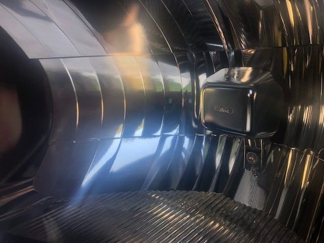

The whole "blinding people" and "getting flashed by oncoming drivers" has WAY more to do with the housing than with the bulb itself.
The factory Ford housing (at least all the ones I have) have a shroud around the bulb that makes it so that all the light comes off the reflector and is aimed like stock (see pic below, the bulb shroud even has a little "Ford" logo on it).
Assuming whatever housing you're using has a bulb shroud like this, then use whatever LED bulb you want without fear of blinding anyone or getting flashed. Personally , I'm a big fan of these bulbs from DieselSite (see link below). I have them in a bunch of vehicles ,even my younger sons retired police crown vic. I tried a bunch of different Amazon knockoffs before finding the DieselSite bulbs.

IDK, I actually didn’t read your responses, I was just responding to the OP question.
But I do 100% stand by what I wrote. If the light is coming off the rear housing reflector ( like the shrouded bulb OEM housings force it too) then the light pattern will be the same regardless of what that light source is ( LED, halogen, HID, freaking candles, whatever, now how far that light is projected, and at what intensity, is subject to the light source, but not the pattern ).
All DOT approved headlights are aim adjustable, if you’re blinding oncoming drivers (using a shrouded bulb OEM housing), then adjust the headlight aim accordingly
Cheap Chinese knockoff housings (like frequently sold on Amazon or eBay) often don’t have the bulb shroud. There is no hope of getting those to have a decent pattern and to not blind oncoming drivers regardless of what bulb gets installed in them.
