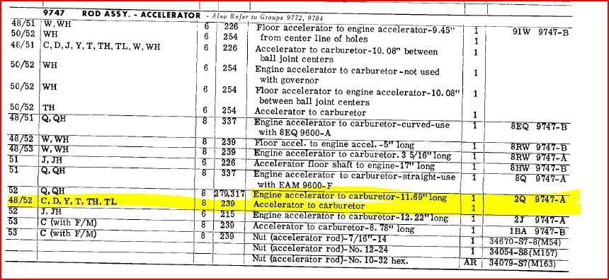

Trying to find a source for the throttle return spring on my 50 f2 239 v-8 engine. Believe number to be 9747-A 11.69". Checked Carpenter, Macs etc. Thanks

I don't know where you got that incorrect and incomplete part number, but what you need is 7EQ-9737-B which is readily available from the usual suspects: https://www.google.com/search?q=7EQ-9737-B

this where I got the part number

Okay, so you are referencing the 1964 printing (not very helpful being 15 years post production). Additionally, group 9747 is for the Accelerator Rod Assembly, not the throttle return spring. If you wanted the rod assembly, 2Q-9747-A would be the service part, but you should be seeking the original 59C-9747-C assembly instead.
Lastly, the available throttle return spring is the aforementioned 7EQ-9737-B

Thanks for clearing that up for me. That's what I love about this forum.
