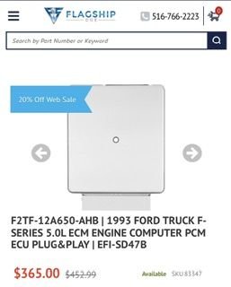

Ecm info needed for 93 f150 5.0 e4od. The one that is in it is # f2tf-ahb. It has gone bad and I can't
find one with the same numbers. Is there
Any others that will work? Thanks for
Any help.

What is the calibration code on the driver’s side B pillar?

Originally Posted by Kenny1
….and I can't
I typed the engineering number into a search engine and came up with this a second or two later

Calibration code is 2-54l-r12

Thanks I will look into those. Any good place to get the original rebuilt for a spare?

I typed that calibration code into the search engine and came up with another thread about that code. In that thread was a link to another thread.
I would be skeptical of a place that says the computer has been “programmed and flashed” since you cannot do that to these OBD-I computers.
There have been a couple places mentioned to have the capacitors replaced if you cannot do it yourself but I don’t know offhand. Use the search function in this forum to see if you can find them.

You could look for any SD47B hardware, that should work.
