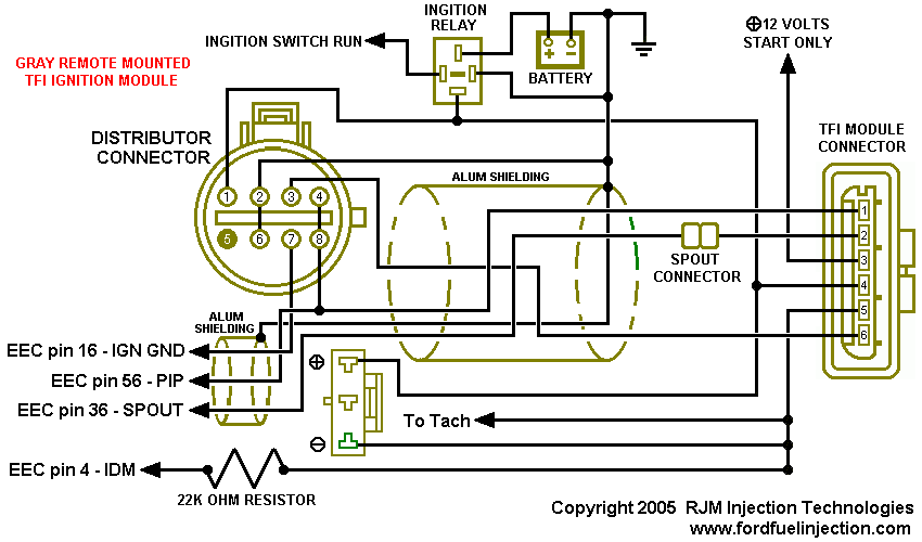

Distributor/Tfi module wiring question
Trying to upgrade/relocate my 1991 w/5.8 tfi module and distributor. I've seen two versions of wiring my 8 pin connector distributor to my 6 pin tfi module. Anyone offer any clarity for me? The tfi is grey. The difference is at the distributor connector, mainly pins 4&8 together (or not) and pins 2&6 together (or not). Thanks for the help. EDIT: Answered my own question, those pins I was wondering about are already common at the distributor
