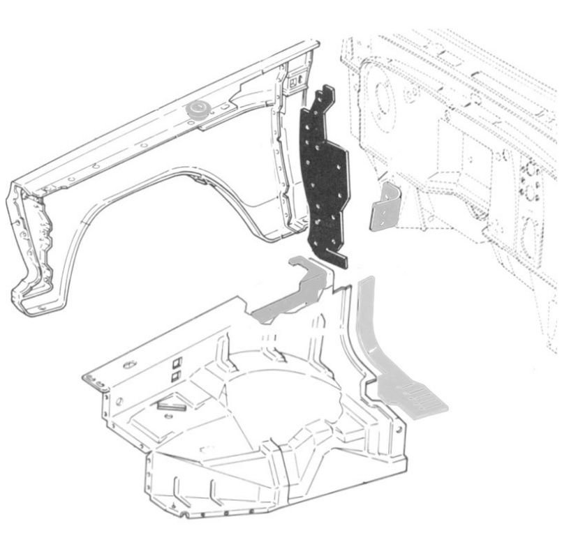

After I got my truck back from the painter in 2022, with the new fenders, etc. but before I got my OEM front inner fender tubs back in place, Wife and I took it to town and the wind whistles were loud. I chased seals and found that the noise was up along the front edge of the door and so I thought was vent glass seals. I had all new seals, door seals, glass runs, vent seals, and all was right, but still she whistled at 45-50 or faster. The truck had never whistled like that in all the years and road trips since 1986. Seriously, that whistle was almost killing my enjoyment of driving it. It's been from Alabama, S,C., Ga., Vermont, N.Y., Delaware, Ohio, Tenn., Ky., W.Va., and since I live in Va. so all over Va. Then one day I put the front wheel tub liners back in place, drilled the screw holes, etc. It never whistled again after I put those tubs back in that day.To me, the most important benefit they provide is keeping air pressure off the front of the door there behind that tunnel between the front tire and the door, behind the fender. I'd resist $300 for new ones, but knowing the difference, in time I'd do it if ...
... if I tried the flat heavy rubber like ones used on the earlier Dents and if they didn't work. Those fasten to the cab and the fender back behind the wheel too, and likely break up that direct tunnel to the door too. $30 or less .... worth a try. If they work, get the other pieces like fender to apron near hinges, etc.
