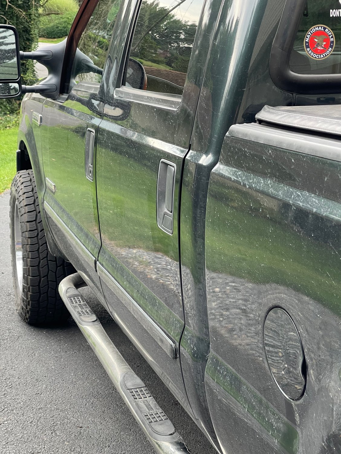

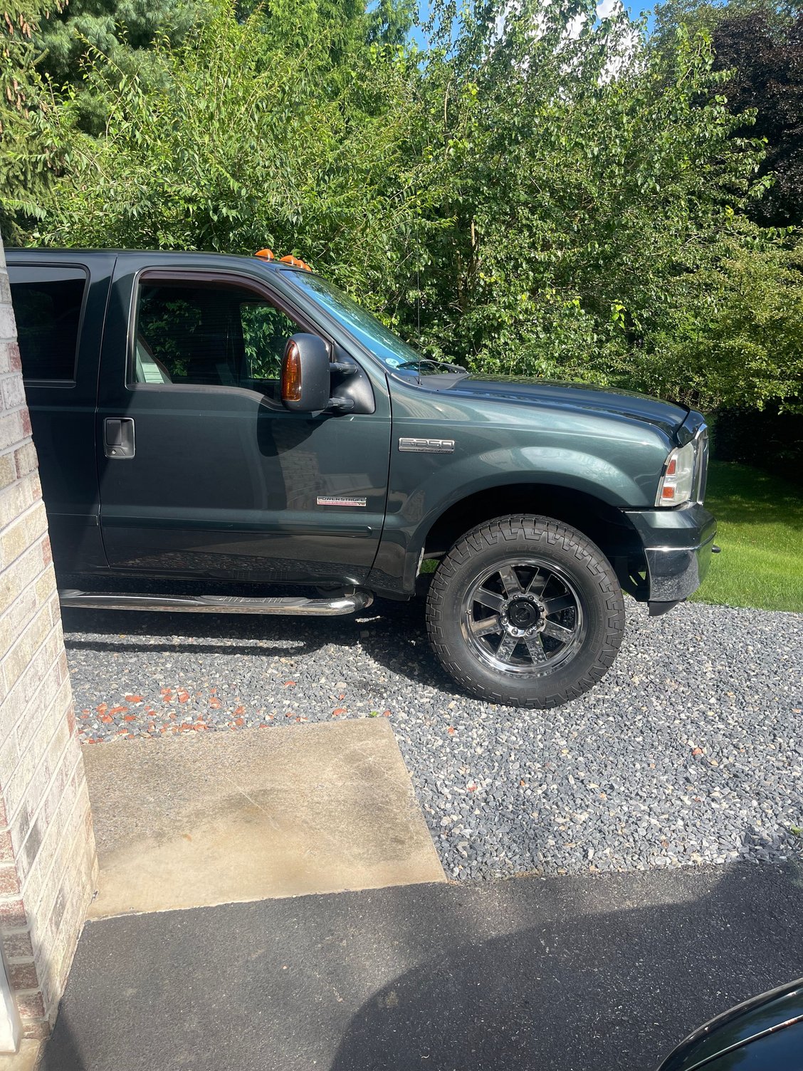

Most stock wheels are a + offset so the tires sit behind the fenders. A zero offset means that bolting face of the rim is exactly in the middle of the rim. A negative offset moves that bolting surface closer to the vehicle pushing the rim away from the vehicle.
These are Moto Metals without the center caps with a 0 offset and Cooper 275/65R20 tires. They are the largest diameter tire I can fit without rubbing lock to lock. If I remember correctly they are 34.4” diameter. They stick out about 3/4” beyond the fenders.

Wow even a 0 offset is more poke than I'd prefer.
Thanks for the pictures.

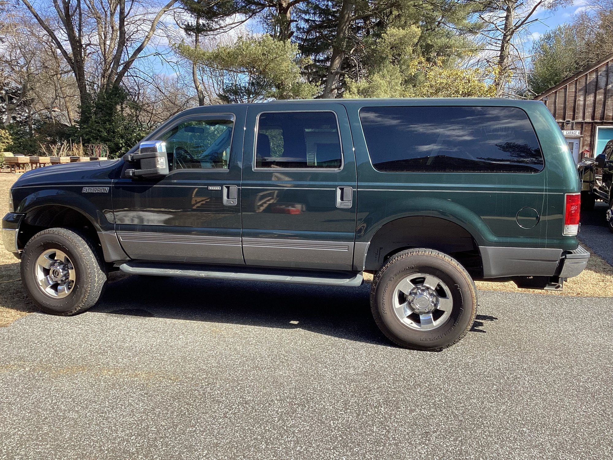

Are you currently running spacers with those OEM 20”s? If not, I would think that you are rubbing the tires on the front leaf springs well before getting to steering lock.
Your original wheels along with those 20”s are hubcentric so using thin spacers like you mentioned may push the wheels out off of the hub leaving them uncentered.
Up until the end of ‘04 the only 16”+ OEM SD wheels were the 4 similar, but unique versions of the 5 spoke ‘04 Lariat, King Ranch, Harley Davidson and SVT 18”X8”. These 18” wheels have the correct geometry to properly fit the pre ‘05 trucks without the need for spacers keeping the tires inside the fenders where they belong. I run the ‘04 Lariat 18X8 wheels on my Excursion with 305/70R18 Nitto Dura Grapplers (35.25”X12.8”). The tires are completely under the truck and only slightly rub the front springs at full lock due to the bigger tires. This series of wheel are kind of rare but are still out there and are a good solid OEM choice for the pre ‘05 trucks.
This thread is from the Excursion section of the forum, I wrote it up for the big wagon folks but it also applies to the pickups up until model year ‘04.
