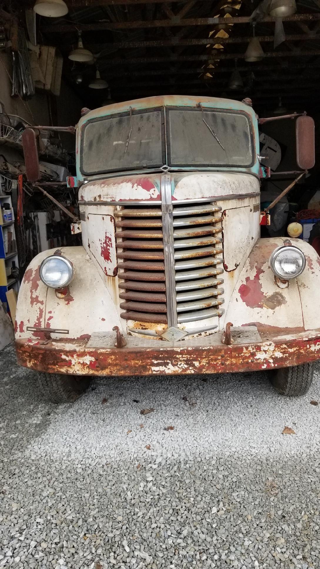

does any have a place to buy a kit or rebuild my coe engines
I have ford 1938 1952
gmc 1945 detroit diesel
1945 diamond t
